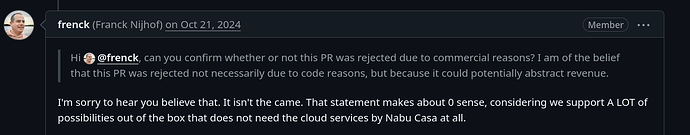

To why they didn’t want to do it, Frenck answered here:
These methods add complexity and maintenance burden to our project for a quite complex feature, a niche/lesser wide spread in use

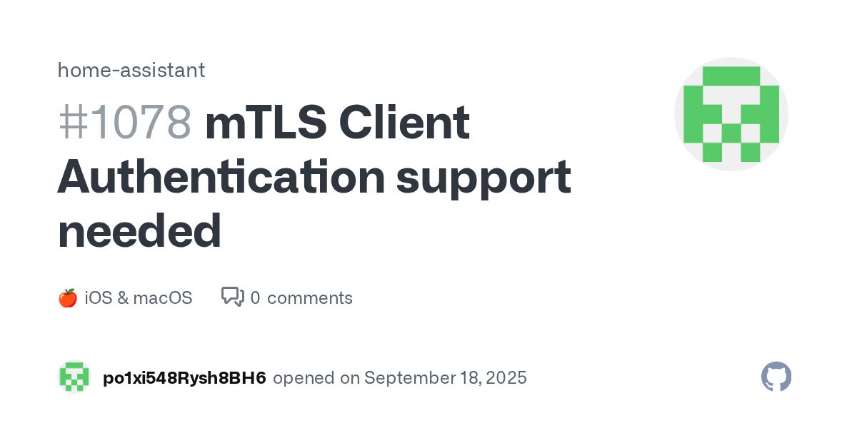

Apparently Feature requests been moved to Github, so the new link that we can vote there
