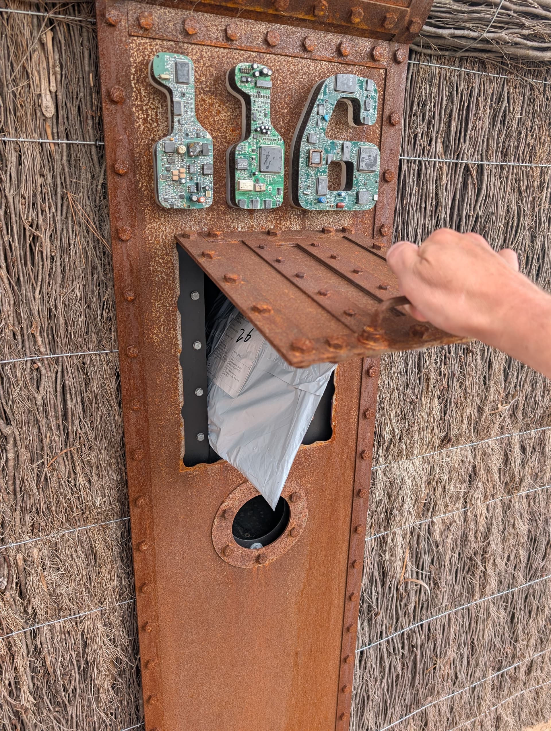

I am using one to monitor the newspaper /junk mail big round hole in my letterbox. (the parcel and letter flaps have micro switches)
Issues with PIR :
  • sunlight can set them off, either direct or shining on your letterbox and heating it up. A person, bird or object throwing a shadow can then make enough difference to set it off, even if it didn’t see their ā€œmovementā€
  • insects, moths, ants… They might be small, but if they crawl over the sensor they look very BIG
  • spiders (see above) AND their little barely noticeable thin wispy webs are excellent at reflecting UV and infra-red light. So up close they look like someone waving an arm in front of the sensor…
  • The plastic used to make the lens / dome on cheap PIR sensors gets destroyed by UV / sunlight pretty quickly outside
I don’t think vibration would trigger it that much if the sensor is securely mounted to the mailbox. If there is vibration (like wind for example) the sensor and the mailbox interior is moving as one, so = no relative motion.
On really windy days, my fence moves in the wind enough to trigger the micro switch for the gate, but it’s never set off the PIR (mailbox is mounted in the fence)
… But on a still night when a moth wants to have a look, or a spider wants to eat the moth… I get a lot of newspapers ā€œdeliveredā€ apparently :rofl:
