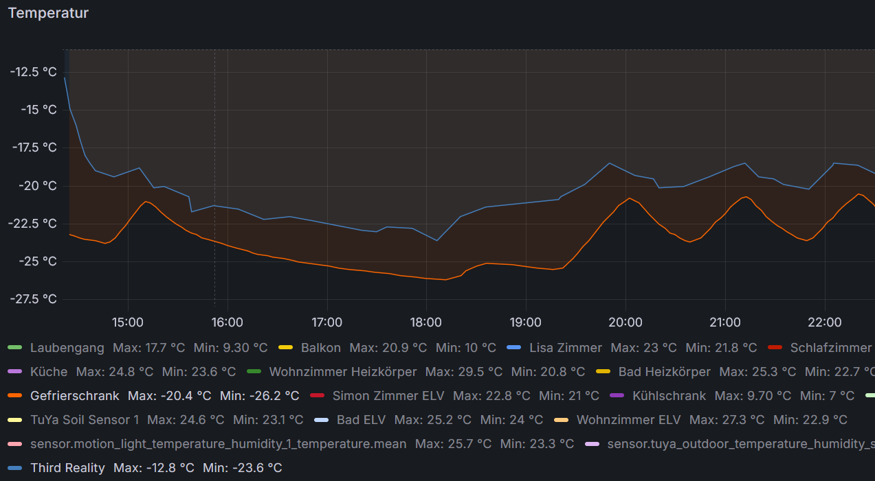

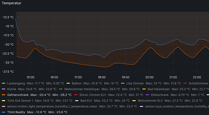

i did finally find a sensor which is zigbee, uses standard batteries (2xAAA) and does work in my freezer:
…have tested it against my home-built homematic sensor (with BME280 sensor), see graph below, and it works without problem down to -24°C
…the measured values seem to be a bit off against my other sensor, but is working :slight_smile:
…can’t say anything about runtime of the batteries yet…
