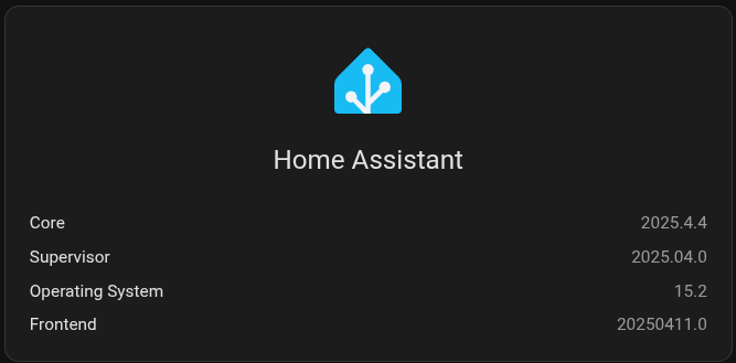

I have followed the instructions available on the GitHub site, and have restarted HA after each attempt. I have the following version:

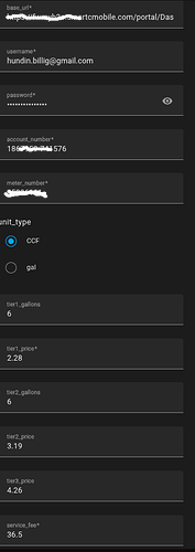

I have this under the ‘Configure’ tab:
It’s that 1st field (base url) that I’d be most suspicious of. Can you add the value you are using? I don’t think there’s too much sensitive there, it’ll likely tell us where you are (mine includes my-slc - Salt Lake City), but shouln’t say much else.
You seem to have …/portal/Das… in there - which I wouldn’t expect in a ‘base’ URL. And I don’t see ‘sensus-analytics’ (may be OK, depending on how your utility packages it, but different from mine that is working). Maybe add a screenshot of the ‘Usage Details’ or ‘Meters’ page of your utilities web site - just wanting to make sure it is sensus analytics based and how deeply it’s embedded into your utilities web site!

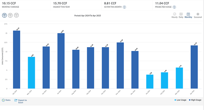

There isn’t a “Meter” page, but this is what is on the billing statement. The city lists these as in use:
I am only assuming that this residential area is using the SRII meters, the house is only about 4 years old.

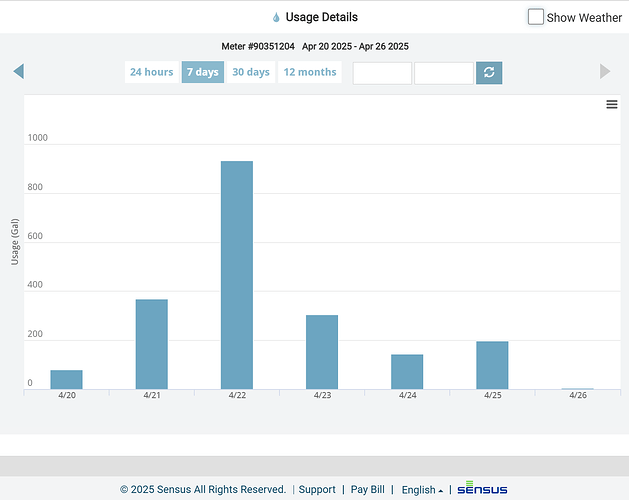

I have a feeling that your utility isn’t using sensus analytics. Here’s what my (Salt Lake) usage page looks like (note the copyright & logo at the bottom):
Yours looks like it uses “SEW - Smart Energy Water” and unfortunately, a quick search of this forum didn’t bring up an obvious integration for that.
