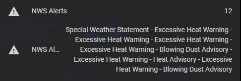

@finity just FYI put a lil PR in for the config flow, it auto populates the zone id(s) based on the lat/lon from Home Assistant.
Seems to be handling excessive alerts well too:
Ooof
That looks like no fun at all.
