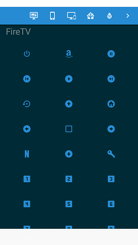

Thanks but sorry, I misunderstood. I thought you had scripts that controlled the TV rather than the Harmony Hub.
I have a small remote that I default to. I am using the Conditional Card to hide what is un-needed at the moment. When the TV is off I can just click Netflix, DVD, or Satellite to run a script to turn the TV on and get started. Clicking the Netflix button: sets the remote to Netflix mode, turns on the TV and the FireTV, sets the TV to the FireTV input, and sets the FireTV to the Netflix app. The remote provides TV power, Volume, Mute functions and the most relevant buttons for the device I am using.
Once I select Netflix I have the normal controls that I use with Netflix. The key icon runs a script that enters our parental controls passcode. The DVD remote gives an eject button.
I also have a full remote for each device.

Do you have your config for this? You’ve already done Almost exactly what I’ve been brainstorming all day
Ian Welcome to the community! There is a lot that goes into this… most of the buttons are scripts that run a particular series of commands to accomplish the given function. I even have an automation that takes the TV’s input and updates the remote so if I start somewhere else the remote is updated. here is the Lovelace code… and below that are some of the scripts.

service_data:
entity_id: media_player.fire_tv
command: "HOME"
- entity: script.fire_netflix
hold_action:
action: toggle
icon: "mdi:netflix"
tap_action:
action: toggle
- entity: script.fire_left
hold_action:
action: toggle
icon: "mdi:arrow-left-bold-circle"
tap_action:
action: call-service
service: androidtv.adb_command
service_data:
command: "LEFT"
- entity: script.fire_enter
hold_action:
action: toggle
icon: "mdi:checkbox-blank-outline"
tap_action:
service_data:
command: "CENTER"
- entity: script.fire_right
hold_action:
action: toggle
icon: "mdi:arrow-right-bold-circle"
tap_action:
service_data:
command: "RIGHT"
- entity: script.tv_dvd
hold_action:
service: mqtt.publish
service_data:
payload: DVD Player
qos: 0
retain: false
topic: ha/lgtv/source
icon: "mdi:disc-player"
tap_action:
action: toggle
- entity: script.fire_netflix_auth
hold_action:
action: toggle
icon: "mdi:key"
tap_action:
action: toggle
- entity: script.fire_down
hold_action:
action: toggle
icon: "mdi:arrow-down-bold-circle"
tap_action:
service_data:
command: "DOWN"
- entity: script.fire_menu
hold_action:
action: toggle
icon: "mdi:menu"
tap_action:
service_data:
command: "MENU"
- entity: script.tv_sat
hold_action:
action: toggle
icon: "mdi:satellite-uplink"
tap_action:
action: toggle
show_name: false
show_state: false
type: glance
conditions:
- entity: sensor.lg_tv_source
state: FireTV
- entity: binary_sensor.frontnode2_status
state: "off"
type: conditional
- card:
columns: 4
entities:
- entity: switch.tv_toggle
hold_action:
action: toggle
icon: "mdi:monitor"
tap_action:
action: toggle
hold_action:
service_data:
payload: FireTV
qos: 0
retain: false
icon: "mdi:netflix"
tap_action:
action: toggle
hold_action:
service_data:
payload: DVD Player
qos: 0
retain: false
tap_action:
action: toggle
hold_action:
action: toggle
tap_action:
action: toggle
show_name: false
show_state: false
type: glance
conditions:
state: "off"
type: conditional
- card:
columns: 4
entities:
hold_action:
service_data:
payload: "off"
qos: 0
retain: false
icon: "mdi:monitor"
tap_action:
action: toggle
- entity: script.tv_mute
hold_action:
action: toggle
icon: "mdi:volume-mute"
tap_action:
action: toggle
- entity: script.tv_volume_down
hold_action:
action: toggle
icon: "mdi:volume-minus"
tap_action:
action: toggle
- entity: script.tv_volume_up
hold_action:
action: toggle
icon: "mdi:volume-plus"
tap_action:
action: toggle
- entity: script.tv_media_backward
hold_action:
action: toggle
icon: "mdi:skip-previous-circle"
tap_action:
action: toggle
- entity: script.tv_media_play
hold_action:
action: toggle
icon: "mdi:play-circle"
tap_action:
action: toggle
- entity: script.tv_media_pause
hold_action:
action: toggle
icon: "mdi:pause-circle"
tap_action:
action: toggle
- entity: script.tv_media_forward
hold_action:
action: toggle
icon: "mdi:skip-next-circle"
tap_action:
action: toggle
- entity: script.tv_return
hold_action:
action: toggle
icon: "mdi:undo"
tap_action:
action: toggle
- entity: script.tv_up
hold_action:
action: toggle
icon: "mdi:arrow-up-bold-circle"
tap_action:
action: toggle
- entity: script.tv_list
hold_action:
action: toggle
icon: "mdi:home"
tap_action:
action: toggle
hold_action:
action: toggle
icon: "mdi:netflix"
tap_action:
action: toggle
- entity: script.tv_left
hold_action:
action: toggle
tap_action:
action: toggle
- entity: script.tv_enter
hold_action:
action: toggle
tap_action:
action: toggle
- entity: script.tv_right
hold_action:
action: toggle
tap_action:
action: toggle
hold_action:
service_data:
payload: DVD Player
qos: 0
retain: false
tap_action:
action: toggle
- entity: script.tv_source
hold_action:
action: toggle
icon: "mdi:ethernet-cable"
tap_action:
action: toggle
- entity: script.tv_down
hold_action:
action: toggle
tap_action:
action: toggle
- entity: script.tv_menu
hold_action:
action: toggle
icon: "mdi:menu"
tap_action:
action: toggle
hold_action:
action: toggle
tap_action:
action: toggle
show_name: false
show_state: false
title: TV
type: glance
conditions:
state_not: "off"
state_not: "FireTV"
state_not: "DVD Player"
type: conditional
title: "\U0001F5A5 Media"
type: "custom:vertical-stack-in-card"
