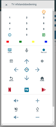

I didn’t, it’s just a regular glance card nested inside of an entities card (for the top TV switch) but you could also use a vertical stack card for that.
All the buttons are just scripts with mdi icons. So I have multiple entries in a glance card like this:
- entity: script.tvsmartmenu
  icon: 'mdi:home'
  tap_action:
    action: call-service
    service: script.tvsmartmenu
These scripts call out a broadlink service to send an infrared command.
The white spaces are done by making a script and giving it a non-existing icon + empty character as friendly name. Inside my scripts.yaml:
empty:
  sequence:
  - data: {}
    entity_id: script.justsomerandomtext
    service: script.turn_on
Inside customize.yaml:
script.empty:
  friendly_name: ‏‏‎ ‎
  icon: mdi:justsomerandomtext
Combine all of that and you get something like this https://hastebin.com/eyokeyahif.sql (top part of the screenshot I posted)

My remote
type: custom:stack-in-card
mode: vertical
cards:
  - type: horizontal-stack
    cards:
      - type: custom:button-card
        styles:
          card:
            - height: 50px
            - margin: 0px
        styles:
          card:
            - height: 50px
            - margin: 0px
        tap_action:
          service: remote.send_command
          service_data:
            entity_id: remote.sony_bravia_tv
            command: TvPower
        entity: remote.sony_bravia_tv
        icon: mdi:power
        show_name: false
        show_state: true
        show_entity_picture: false
        show_icon: true
        styles:
          card:
            - height: 50px
            - margin: 0px
          img_cell:
            - align-self: start
            - position: relative
            - margin: 0px 0px 0px 0px
          state:
            - font-size: 12px
            - font-family: Sans-serif
            - font-color: rgba(255, 0, 0, 0.8)
            - text-transform: capitalize
            - margin: '-10px 0px -12px 0px'
          icon:
            - color: orange
            - width: 50px
    cards:
        tap_action:
          service_data:
            command: Num1
        show_name: true
        styles:
          card:
            - height: 45px
            - margin: 0px
          name:
            - font-size: 18px
            - font-weight: bold
        tap_action:
          service_data:
            command: Num2
        show_name: true
        styles:
          card:
            - height: 45px
            - margin: 0px
          name:
            - font-size: 18px
            - font-weight: bold
        tap_action:
          service_data:
            command: Num3
        show_name: true
        styles:
          card:
            - height: 45px
            - margin: 0px
          name:
            - font-size: 18px
            - font-weight: bold
    cards:
        tap_action:
          service_data:
            command: Num4
        show_name: true
        styles:
          card:
            - height: 45px
            - margin: 0px
          name:
            - font-size: 18px
            - font-weight: bold
        tap_action:
          service_data:
            command: Num5
        show_name: true
        styles:
          card:
            - height: 45px
            - margin: 0px
          name:
            - font-size: 18px
            - font-weight: bold
        tap_action:
          service_data:
            command: Num6
        show_name: true
        styles:
          card:
            - height: 45px
            - margin: 0px
          name:
            - font-size: 18px
            - font-weight: bold
    cards:
        tap_action:
          service_data:
            command: Num7
        show_name: true
        styles:
          card:
            - height: 45px
            - margin: 0px
          name:
            - font-size: 18px
            - font-weight: bold
        tap_action:
          service_data:
            command: Num8
        show_name: true
        styles:
          card:
            - height: 45px
            - margin: 0px
          name:
            - font-size: 18px
            - font-weight: bold
        tap_action:
          service_data:
            command: Num9
        show_name: true
        styles:
          card:
            - height: 45px
            - margin: 0px
          name:
            - font-size: 18px
            - font-weight: bold
    cards:
        tap_action:
          service_data:
            command: Display
        icon: mdi:information-outline
        show_name: false
        show_icon: true
        styles:
          card:
            - height: 45px
            - margin: 0px
          name:
            - font-size: 12px
            - margin-bottom: 0px
          img_cell:
            - align-self: start
            - margin: 0px
          icon:
            - width: 27px
            - margin: 0px
            - color: '#31759b'
        tap_action:
          service_data:
            command: Num0
        show_name: true
        styles:
          card:
            - height: 45px
            - margin: 0px
          name:
            - font-size: 18px
            - font-weight: bold
        tap_action:
          service_data:
            command: Teletext
        icon: mdi:text-box-outline
        show_name: false
        show_icon: true
        styles:
          card:
            - height: 45px
            - margin: 0px
          name:
            - font-size: 12px
          img_cell:
            - align-self: start
            - margin: 0px
          icon:
            - width: 27px
            - margin: 0px
            - color: green
  - type: custom:gap-card
    height: 15
    cards:
        tap_action:
          service_data:
            command: Red
        icon: mdi:card
        show_name: false
        show_icon: true
        styles:
          card:
            - height: 30px
            - margin: 0px
          name:
            - font-size: 12px
          img_cell:
            - align-self: start
            - margin: 0px
          icon:
            - width: 30px
            - margin: 0px
            - color: red
        tap_action:
          service_data:
            command: Green
        icon: mdi:card
        show_name: false
        show_icon: true
        styles:
          card:
            - height: 30px
            - margin: 0px
          name:
            - font-size: 12px
          img_cell:
            - align-self: start
            - margin: 0px
          icon:
            - width: 30px
            - margin: 0px
            - color: green
        tap_action:
          service_data:
            command: Yellow
        icon: mdi:card
        show_name: false
        show_icon: true
        styles:
          card:
            - height: 30px
            - margin: 0px
          name:
            - font-size: 12px
          img_cell:
            - align-self: start
            - margin: 0px
          icon:
            - width: 30px
            - margin: 0px
            - color: yellow
        tap_action:
          service_data:
            command: Blue
        icon: mdi:card
        show_name: false
        show_icon: true
        styles:
          card:
            - height: 30px
            - margin: 0px
          name:
            - font-size: 12px
          img_cell:
            - align-self: start
            - margin: 0px
          icon:
            - width: 30px
            - margin: 0px
            - color: blue
  - type: entities
    entities:
      - type: divider
  - type: vertical-stack
    cards:
        cards:
            tap_action:
              service_data:
                command: EPG
            icon: mdi:television-guide
            show_name: true
            show_icon: true
            styles:
              card:
                - height: 50px
                - margin: 0px
              name:
                - align-self: start
                - position: absolute
                - font-size: 12px
                - margin: 32px 0px 0px 0px
              img_cell:
                - align-self: start
                - margin: 0px
              icon:
                - width: 30px
                - margin: 0px
                - color: '#31759b'
            tap_action:
              service_data:
                command: none
            icon: mdi:microphone-outline
            show_name: false
            show_icon: true
            styles:
              card:
                - height: 50px
                - margin: 0px
              img_cell:
                - align-self: start
                - margin: 0px
              state:
                - font-size: 12px
                - margin: 0px
              icon:
                - width: 35px
                - color: '#46545c'
            tap_action:
              service_data:
                command: OneTouchView
            icon: mdi:record
            show_name: true
            show_icon: true
            styles:
              card:
                - height: 50px
                - margin: 0px
              name:
                - align-self: start
                - font-size: 12px
              img_cell:
                - align-self: start
                - margin: 0px
              icon:
                - width: 32px
                - margin: 0px
                - color: '#31759b'
        height: 25
        cards:
            tap_action:
              service_data:
                command: Input
            icon: mdi:application-import
            show_name: false
            show_icon: true
            styles:
              card:
                - height: 50px
                - margin: 0px
              name:
                - font-size: 12px
              img_cell:
                - align-self: start
                - margin: 0px
              icon:
                - width: 30px
                - margin-bottom: 1px
                - color: '#46545c'
            tap_action:
              service_data:
                command: Up
            icon: mdi:arrow-up
            show_name: false
            show_icon: true
            styles:
              card:
                - height: 65px
                - margin: 0px
              img_cell:
                - align-self: start
                - margin: 0px
              state:
                - font-size: 12px
                - margin: 0px
              icon:
                - width: 60px
                - color: '#7290aa'
            tap_action:
              service_data:
                command: Options
            icon: mdi:cog-outline
            show_name: false
            show_icon: true
            styles:
              card:
                - height: 50px
                - margin: 0px
              name:
                - font-size: 12px
              img_cell:
                - align-self: start
                - margin: 0px
              icon:
                - width: 34px
                - margin: 0px
                - color: '#46545c'
        cards:
            tap_action:
              service_data:
                command: Left
            icon: mdi:arrow-left
            show_name: false
            show_icon: true
            styles:
              card:
                - height: 65px
                - margin: 0px
              name:
                - font-size: 12px
              img_cell:
                - align-self: start
                - margin: 0px
              icon:
                - width: 50px
                - margin: 0px
                - color: '#7290aa'
            tap_action:
              service_data:
                command: Confirm
            icon: mdi:crosshairs
            show_name: true
            show_icon: true
            styles:
              card:
                - height: 65px
                - margin: 0px
              name:
                - align-self: start
                - font-size: 12px
                - font-weight: bold
                - margin: 21px 0px 0px 0px
              img_cell:
                - align-self: start
                - margin: 0px
              state:
                - font-size: 12px
                - margin: 0px
              icon:
                - width: 35px
                - color: '#516377'
                - margin: 0px
            tap_action:
              service_data:
                command: Right
            icon: mdi:arrow-right
            show_name: false
            show_icon: true
            styles:
              card:
                - height: 65px
                - margin: 0px
              name:
                - font-size: 12px
              img_cell:
                - align-self: start
                - margin: 0px
              icon:
                - width: 50px
                - margin: 0px
                - color: '#7290aa'
        cards:
            tap_action:
              service_data:
                command: Return
            icon: mdi:undo-variant
            show_name: true
            show_icon: true
            styles:
              card:
                - height: 60px
                - margin: 10px 0px 0px 0px
              name:
                - align-self: start
                - font-size: 12px
                - font-weight: bold
                - margin: 40px 0px 0px 0px
              img_cell:
                - align-self: start
                - margin: 0px
              icon:
                - width: 40px
                - margin: 0px
                - color: '#46545c'
            tap_action:
              service_data:
                command: Down
            icon: mdi:arrow-down
            show_name: false
            show_icon: true
            styles:
              card:
                - height: 65px
                - margin: 0px
              img_cell:
                - align-self: start
                - margin: 0px
              state:
                - font-size: 12px
                - margin: 0px
              icon:
                - width: 55px
                - color: '#7290aa'
            tap_action:
              service_data:
                command: Home
            icon: mdi:home
            show_name: true
            show_icon: true
            styles:
              card:
                - height: 60px
              name:
                - align-self: start
                - font-size: 12px
                - font-weight: bold
              img_cell:
                - align-self: start
                - margin: 0px
              icon:
                - width: 40px
                - margin: 0px
                - color: '#46545c'
        height: 25
    cards:
        cards:
            tap_action:
              service_data:
                command: Netflix
            icon: mdi:netflix
            show_name: false
            show_icon: true
            styles:
              card:
                - height: 50px
                - margin: 0px
              name:
                - font-size: 12px
              img_cell:
                - align-self: start
                - margin: 0px
              icon:
                - width: 40px
                - margin: 0px
                - color: red
            tap_action:
              service_data:
                command: Tv
            icon: mdi:television-box
            show_name: false
            show_icon: true
            styles:
              card:
                - height: 55px
                - margin: 0px
              name:
                - font-size: 12px
              img_cell:
                - align-self: start
                - margin: 0px
              icon:
                - width: 50px
                - margin: 0px
                - color: '#31759b'
            tap_action:
              service_data:
                command: AndroidMenu
            icon: mdi:google-play
            show_name: false
            show_icon: true
            styles:
              card:
                - height: 50px
                - margin: 0px
              name:
                - font-size: 12px
              img_cell:
                - align-self: start
                - margin: 0px
              icon:
                - width: 50px
                - margin: 0px
                - color: red
      - type: entities
        entities:
          - type: divider
    cards:
        cards:
            tap_action:
              service_data:
                command: VolumeUp
            icon: mdi:volume-plus
            show_name: false
            show_icon: true
            styles:
              card:
                - height: 65px

The code is ‘gaos’ its much, maybe someone has a better idea to reduce the code…
nice remote I like it, I might implement some of it!
I’m curious about the microphone what exactly does it do? does it wake up a near by echo or google nest ?
Thanks
@Ricks88, you may use YAML anchors to reduce the code - eg. define block with &ref_0 and reuse with *ref_0.
Would you mind sharing the last portion of your pilot? The code you shared is missing the forward/play section.
eg.

@bbiegun
Thanks for the advise, i never knew about that. How or where can i define those blocks? and can i use them on other pages to?
My code was to long to place the last part, i will split the code in 2 posts.
Code is a bit changed in the time between.
@bbiegun
Part 1

                      command: EPG
                  show_name: true
                  show_icon: true
                  styles:
                    card:
                      - height: 50px
                      - margin: 0px
                    name:
                      - align-self: start
                      - font-size: 12px
                      - margin: 25px 0px 0px 0px
                    img_cell:
                      - align-self: start
                      - margin: '-8px 0px 0px 0px'
                    icon:
                      - width: 30px
                      - margin: 0px
                      - color: '#31759b'
                  tap_action:
                    service_data:
                      command: none
                  show_name: false
                  show_icon: true
                  styles:
                    card:
                      - height: 50px
                      - margin: 0px
                    img_cell:
                      - align-self: start
                      - margin: '-3px 0px 0px 0px'
                    state:
                      - font-size: 12px
                      - margin: 0px
                    icon:
                      - width: 38px
                      - color: '#46545c'
                  tap_action:
                    service_data:
                  icon: mdi:record
                  show_name: true
                  show_icon: true
                  styles:
                    card:
                      - height: 50px
                      - margin: 0px
                    name:
                      - align-self: start
                      - font-size: 12px
                    img_cell:
                      - align-self: start
                    icon:
                      - width: 32px
                      - margin: 0px
                      - color: '#31759b'
              height: 25
              cards:
                  tap_action:
                    service_data:
                      command: Input
                  show_name: false
                  show_icon: true
                  styles:
                    card:
                      - height: 50px
                      - margin: 0px
                    name:
                      - font-size: 12px
                    img_cell:
                      - align-self: start
                      - margin: 5px 0px 0px 25px
                    icon:
                      - width: 25px
                      - margin: 0px
                      - color: '#46545c'
                  tap_action:
                    service_data:
                      command: Up
                  icon: mdi:arrow-up
                  show_name: false
                  show_icon: true
                  styles:
                    card:
                      - height: 65px
                      - margin: 0px
                    img_cell:
                      - align-self: start
                      - margin: 0px
                    state:
                      - font-size: 12px
                      - margin: 0px
                    icon:
                      - width: 60px
                      - color: '#7290aa'
                  tap_action:
                    service_data:
                      command: Options
                  show_name: false
                  show_icon: true
                  styles:
                    card:
                      - height: 50px
                      - margin: 0px
                    name:
                      - font-size: 12px
                    img_cell:
                      - align-self: start
                      - margin: 5px 25px 0px 0px
                    icon:
                      - width: 25px
                      - margin: 0px
                      - color: '#46545c'
              cards:
                  tap_action:
                    service_data:
                      command: Left
                  show_name: false
                  show_icon: true
                  styles:
                    card:
                      - height: 65px
                      - margin: 0px
                    name:
                      - font-size: 12px
                    img_cell:
                      - align-self: start
                      - margin: 0px 0px 0px 100px
                    icon:
                      - width: 50px
                      - margin: 0px
                      - color: '#7290aa'
                  tap_action:
                    service_data:
                      command: Confirm
                  show_name: true
                  show_icon: true
                  styles:
                    card:
                      - height: 65px
                      - margin: 0px
                    name:
                      - align-self: start
                      - font-size: 12px
                      - font-weight: bold
                      - margin: 20px 0px 0px 0px
                    img_cell:
                      - align-self: start
                      - margin: 0px
                    state:
                      - font-size: 12px
                      - margin: 0px
                    icon:
                      - width: 40px
                      - color: '#31759b'
                      - margin: 0px
                  tap_action:
                    service_data:
                      command: Right
                  show_name: false
                  show_icon: true
                  styles:
                    card:
                      - height: 65px
                      - margin: 0px
                    name:
                      - font-size: 12px
                    img_cell:
                      - align-self: start
                      - margin: 0px 100px 0px 0px
                    icon:
                      - width: 50px
                      - margin: 0px
                      - color: '#7290aa'
              cards:
                  tap_action:
                    service_data:
                      command: Return
                  show_name: true
                  show_icon: true
                  styles:
                    card:
                      - height: 60px
                      - margin: 0
                    name:
                      - align-self: start
                      - font-size: 11px
                      - font-weight: bold
                      - margin: 42px 0px 0px 25px
                    img_cell:
                      - align-self: start
                    icon:
                      - width: 35px
                      - margin: 0px
                      - color: '#46545c'
                  tap_action:
                    service_data:
                      command: Down
                  show_name: false
                  show_icon: true
                  styles:
                    card:
                      - height: 65px
                      - margin: 0px
                    img_cell:
                      - align-self: start
                      - margin: 0px
                    state:
                      - font-size: 12px
                      - margin: 0px
                    icon:
                      - width: 55px
                      - color: '#7290aa'
                  tap_action:
                    service_data:
                      command: Home
                  icon: mdi:home
                  show_name: true
                  show_icon: true
                  styles:
                    card:
                      - height: 60px
                      - margin: 0px
                    name:
                      - align-self: start
                      - font-size: 11px
                      - font-weight: bold
                      - margin: 42px 25px 0px 0px
                    img_cell:
                      - align-self: start
                    icon:
                      - width: 35px
                      - margin: 0px
                      - color: '#46545c'
              height: 25
        - type: custom:stack-in-card
          mode: vertical
          cards:
              cards:
                  tap_action:
                    service_data:
                      command: Netflix
                  icon: mdi:netflix
                  show_name: false
                  show_icon: true
                  styles:
                    card:
                      - height: 50px
                      - margin: 0px
                    name:
                      - font-size: 12px
                    img_cell:
                      - align-self: start
                    icon:
                      - width: 40px
                      - margin: 0px
                      - color: '#a51521'
                  tap_action:
                    service_data:
                      command: Tv
                  show_name: false
                  show_icon: true
                  styles:
                    card:
                      - height: 55px
                      - margin: 0px
                    name:
                      - font-size: 12px
                    img_cell:
                      - align-self: start
                      - margin: 8px 0px 0px 0px
                    icon:
                      - width: 50px
                      - margin: 0px
                      - color: '#31759b'
                  tap_action:
                    service_data:
                  show_name: false
                  show_icon: true
                  styles:
                    card:
                      - height: 50px
                      - margin: 0px
                    name:
                      - font-size: 12px
                    img_cell:
                      - align-self: start
                    icon:
                      - width: 50px
                      - margin: 0px
                      - color: '#a51521'
            - type: entities
              entities:
                - type: divider

Part 2:
          cards:
              cards:
                  tap_action:
                    service_data:
                      command: VolumeUp
                  show_name: false
                  show_icon: true
                  styles:
                    card:
                      - height: 65px
                      - margin: 0px
                    name:
                      - font-size: 12px
                      - margin: 0px
                    img_cell:
                      - align-self: start
                      - margin: 0px 0px 0px 32px
                    icon:
                      - width: 45px
                      - margin: 0px
                      - color: '#7290aa'
                  tap_action:
                    service_data:
                      command: ChannelUp
                  icon: mdi:plus
                  show_name: false
                  show_icon: true
                  styles:
                    card:
                      - height: 65px
                      - margin: 0px
                    name:
                      - font-size: 12px
                      - margin: 0px
                    img_cell:
                      - align-self: start
                      - margin: 0px 32px 0px 0px
                    icon:
                      - width: 50px
                      - margin: 0px
                      - color: '#7290aa'
              cards:
                  tap_action:
                    service_data:
                      command: Mute
                  icon: mdi:volume-off
                  show_name: true
                  show_icon: true
                  styles:
                    card:
                      - height: 65px
                      - margin: 0px
                    name:
                      - align-self: start
                      - font-size: 12px
                      - margin: 35px 0px 0px 31px
                    img_cell:
                      - align-self: start
                    icon:
                      - width: 30px
                      - margin: 0px
                      - color: '#46545c'
                  tap_action:
                    service_data:
                      command: Jump
                  icon: mdi:sync
                  show_name: true
                  show_icon: true
                  styles:
                    card:
                      - height: 65px
                      - margin: 0px
                    name:
                      - align-self: start
                      - font-size: 12px
                      - margin: 36px 31px 0px 0px
                    img_cell:
                      - align-self: start
                    icon:
                      - width: 30px
                      - margin: 0px
                      - color: '#46545c'
              cards:
                  tap_action:
                    service_data:
                      command: VolumeDown
                  icon: mdi:volume-minus
                  show_name: false
                  show_icon: true
                  styles:
                    card:
                      - height: 65px
                      - margin: 0px
                    name:
                      - font-size: 12px
                      - margin: 0px
                    img_cell:
                      - align-self: start
                    icon:
                      - width: 45px
                      - margin: 0px
                      - color: '#7290aa'
                  tap_action:
                    service_data:
                      command: ChannelDown
                  icon: mdi:minus
                  show_name: false
                  show_icon: true
                  styles:
                    card:
                      - height: 65px
                      - margin: 0px
                    name:
                      - font-size: 12px
                      - margin: 0px
                    img_cell:
                      - align-self: start
                    icon:
                      - width: 50px
                      - margin: 0px
                      - color: '#7290aa'
          height: 1
        - type: entities
          entities:
            - type: divider
          mode: vertical
          cards:
              cards:
                  tap_action:

Also fits in a phone screen via popup now
In that configuration where do I define the different remote configurations?
I don’t see either where are you using the custom:state-switch
Could you please send the full code of the lovelace card?
Have a look at my Github repo. For my button templates, look at my main Lovelace config.
