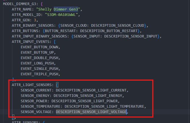

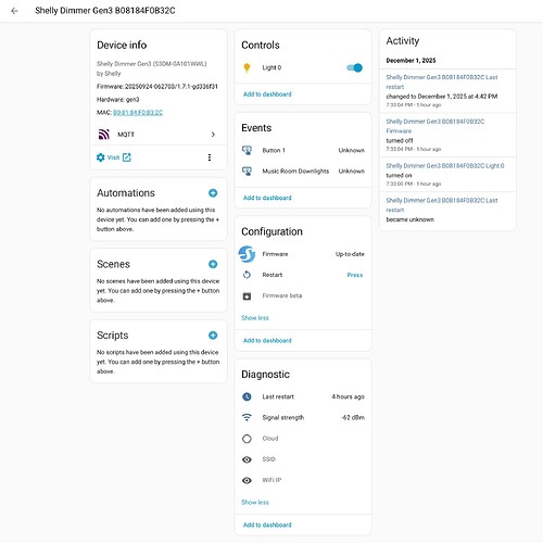

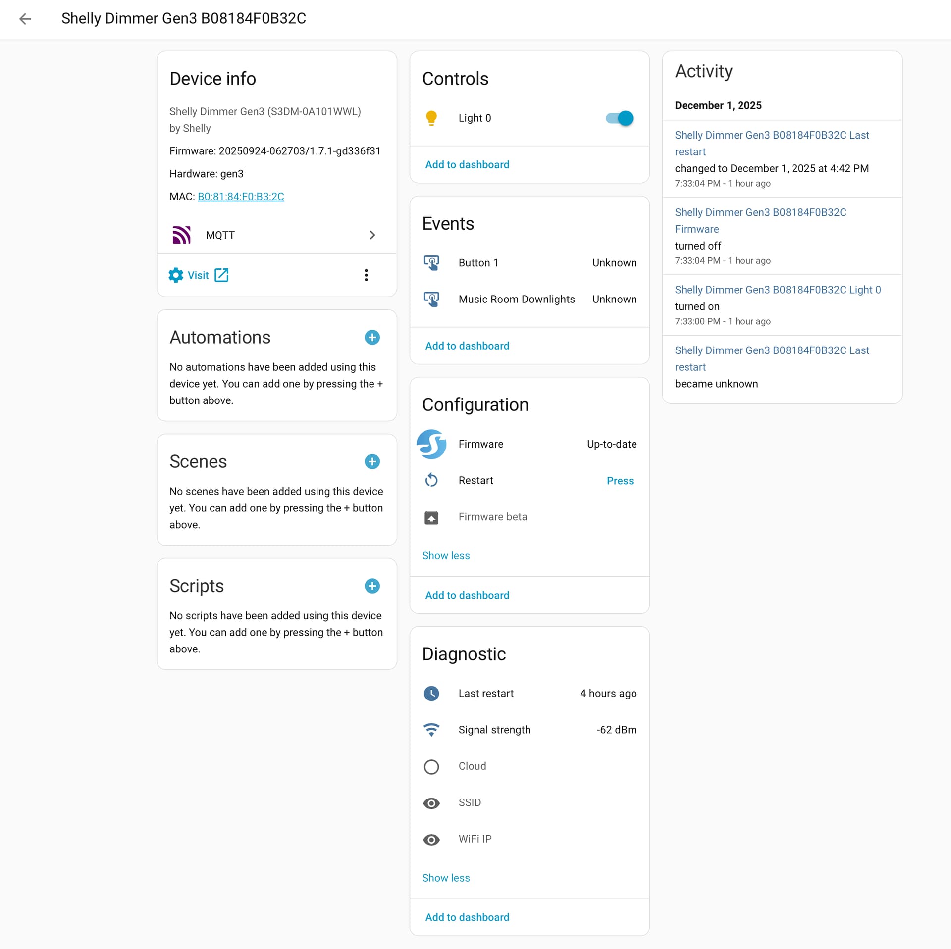

Information could be useful, there are 20 Shelly devices so far, all gen 3, 12 dimmers, the rest are 1PM and mini, and a plus1,they all worked fine on shelly integration, i am rebuilding with everything mqtt, its only the dimmers have this issue,
thanks for your fast response
yes i looked and saw that, for some reason they dont show up, im not sure why
Please catch the log according to this instruction GitHub - bieniu/ha-shellies-discovery-gen2: Script that adds MQTT discovery support for Shellies Gen2+ devices
and open an issue here GitHub · Where software is built and attach the log file.

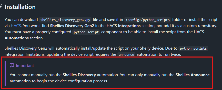

Did you run the shellies_discovery automation manually?
Yes, I have that
it works, thank you
