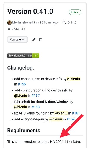

Why are you using the script from master branch?
I have a problem with Shellybutton1. I have done as instructed (hopefully) to setup this script. I downloaded 0.41.0 “shellies_discovery.py” and put it into phyton_scripts (before I had master branch script). I restarted the home assistant several time thinking the problem is in old cached script, as you wrote in previous comment about using master branch script @Bieniu

voluptuous.error.MultipleInvalid: extra keys not allowed @ data['device']['cu']
and here is my shellies_discovery.py:
I updated now to core-2021.11.1 . Shelly button appears now.
