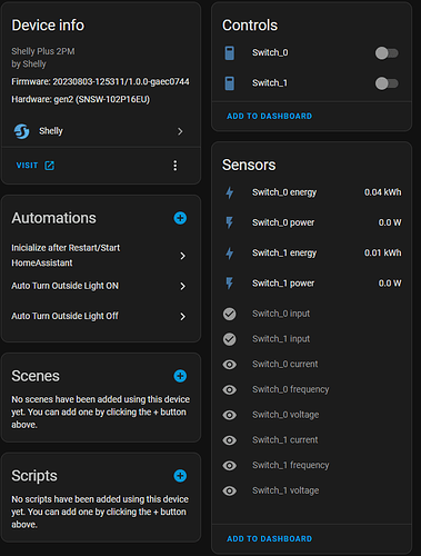

The inputs local switches are unavailable. Is it possible to get it working?
How did you do that? I have the normal sonoff minir4 wifi and i cant use the button as a virtual switch. Just everything physical. Did you wire it special? Because tomorrow the r4 zigbees should arrive.
You have to click on the switch input and then enable it. It is disabled by default.
After that, it took about 30 seconds. Then the Shelly rebooted and I had the switch as an input in HA and could use it in an automation to trigger my smart bulb to turn on and off (without actually cutting power).
this is great, I didnt know that the entity must be activated. Thanks!
