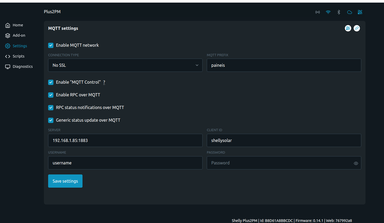

I do have “Generic status update over MQTT” enabled on the Shelly. This configuration should eliminate the log warnings. But re the switch being “unknown,” this is how I was able to reproduce the issue I think you’re describing. When you create the yaml, reload the MQTT entries (Developer Tools, YAML, click on Manually configured MQTT entries). when you do this, you’ll note that the switch goes “unknown.” But after about a minute later, it seems that the shelly pushes out an MQTT status message, and HASS does pick up the true state of the device. Try it.
I think I figured it out - the configuration yaml is correct there are two other things to be mindful of.
First, make sure on you Shelly configuration under MQTT
The checkbox of Generic status update over MQTT
is ticked, otherwise, the status update of the switch is not showing up in the state topic.
Second, what happend to me multiple times is, if you store the config sometimes the password disappears. If that is the case you need to re-paste the password again. This is an annoying bug in the Shelly web UI. You can verify if it works of the small status icon on the top says “connected”.
