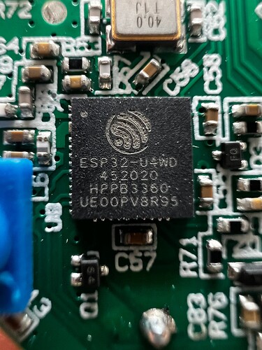

Hi @jiristepan I have tried to flash the shelly plus 1 based on your guide and I am stuck on boot loop, the flashing works, but after the board starts it tries to initialize WiFi or something like that and than restarts. Any idea what could be wrong? I have tried 2 relays with same result.
My test config

you will need his… Read/Write bootloader, partition table and any partition via OTA by angelnu · Pull Request #5535 · esphome/esphome · GitHub
I tried to use just the use flash method. However on Shelly 1 Plus Gen 3 (v 0.2.1) the YAML on the Github
I am getting invalid ID. I dont have the error handy but it had to do with the wrong chip ID. it was similar to boot_comm: mismatch chip ID, expected 0, found 65535
I dont know if the more recent shelly’s have changed something that is not being accounted for in the documentation
This looks helpful
That’s an interesting board although I dont know how it would solve the mismatch chip ID error
