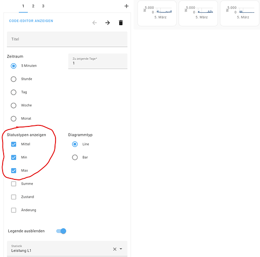

I was too fast. The calculation above gives me the sum of electrical power of the three phases in W. This is what I wanted. The entities for the three phases gives me the possibility use the statistic graphs (see attachment). This I cannot do with the calculated entity.
Any idea what to do to use statistics for the calculated total power?
I hadn’t used it before, but I’m able to add the “Live Power (Watts)” to a Statistics Graph Card. Because it’s a statistic, could it just need some time to accumulate before you can use it in a graph?
I thought so too because I tested just after creating the calculated value. But it is not.
When I take the values for the single phases from Shelly, I can select MIN, MAX and Mean. This also is displayed in the diagram. But when I take the calculated value for total I only have a single value to choose.

I found two solutions by myself quickly. I only took one more day to test before posting an answer:
(1) state_class
The three entities from Shelly integration are state class “measurement”. Your calculation is using state class “total”. I changed the calculation formula to “measurement” and all is fine
state_class: measurement
(2) Helper
Home Assistant provides helper to generate calculations that are not too complex. Using a helper to generate the sum out of the three entities from Shelly integration also provides the expected result.
