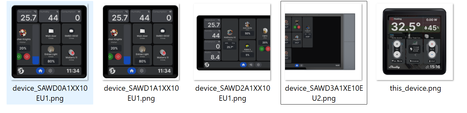

Hi everyone, I don’t know if this is the right place to post this, but I think there is going to be a new Shelly wall display. You probably already know about the X2 display coming out this year, but after looking into the sources of the Stargate APK, I found a folder with images of Shelly wall display models.

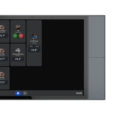

You can see the old one, the new one, and the wide one (SAWD0, SAWD1, SAWD3). However, there is also an image file for a model called SAWD3, which has some buttons on the side, similar to the Sonoff display. In the image you can slightly see a name (XL)
In the code there could also be a hint that it has a camera:
this.mAdapter.addItem((new SettingsAdapter.SettingsItem()).setType(SettingType.TEXT).setName("Open Camera").setAction("cloud.shelly.intent.action.OPEN_CAMERA"));
also the code allows for more then one relay so thats prob the case
for (byte b = 0; b < DeviceSettings.getRelayCount(); b++) {
      this.httpServer.post("/relay/" + b, new ShellyWebSocketServer$$ExternalSyntheticLambda6(this, b));
      this.httpServer.get("/relay/" + b + ".*", new ShellyWebSocketServer$$ExternalSyntheticLambda7(this, b));
I’m not saying this is definitely going to be released, but I think there’s a decent possibility.

MODEL_NAME_BLAKE = "SAWD-3A1XE10EU2"; // Unreleased XL

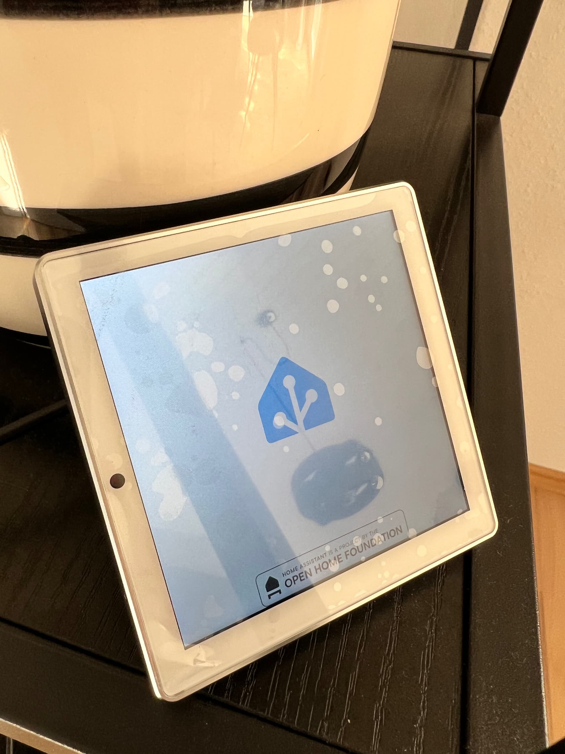

Hi all and especially @RapierXbox,
Thank you very much for your Jailbreak which I just installed on my Wall Display.
I’ve followed your guide and almost everything seems work.
Only problem I have now is that after filling in my HA URL the HA Screen appears but i have no possibility to log into my HA instance. It seems to stuck there.
Have i missed something or what should i do?
I’ve already also reinstalled the latest apk (2.3.0) but without success :frowning:
