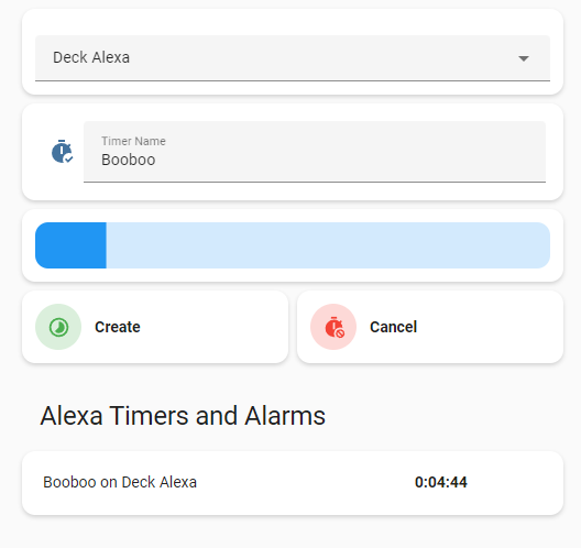

By the way, I was just “mushroom-izing” that screen and I added the cancel.
Card code:
type: vertical-stack
  - type: custom:mushroom-select-card
    entity: input_select.alexa_devices
    icon_type: none
    primary_info: Select Alexa
    secondary_info: ''
    fill_container: true
  - type: entities
      - entity: input_text.alexa_timer_name
        icon: mdi:timer-check
  - type: custom:mushroom-number-card
    entity: input_number.alexa_timer_length
    icon_type: none
    layout: horizontal
    primary_info: none
    secondary_info: none
    display_mode: slider
  - type: horizontal-stack
      - type: custom:mushroom-template-card
        entity: script.create_alexa_timer
        icon: mdi:timelapse
        icon_color: green
        primary: Create
        tap_action:
          action: call-service
          service: script.create_alexa_timer
          service_data:
            mode: create
        icon: mdi:timer-cancel
        icon_color: red
        primary: Cancel
        tap_action:
          service_data:
            mode: cancel
Script code:
alias: Create Alexa Timer
sequence:
  - service: media_player.play_media
    data_template:
      media_content_type: custom
      media_content_id: |-
        {% if mode == 'create' %}
          set {{ states('input_text.alexa_timer_name')}} timer for {{ states('input_number.alexa_timer_length') }} minutes on {{ states('input_select.alexa_devices') }}
        {% else %}
          cancel {{states('input_text.alexa_timer_name') }} timer on {{states('input_select.alexa_devices') }}
      entity_id: media_player.deck_alexa
mode: single
So if I type in “Booboo” and select “Deck Alexa” and hit cancel, it cancels the timer using media_player.play_media.

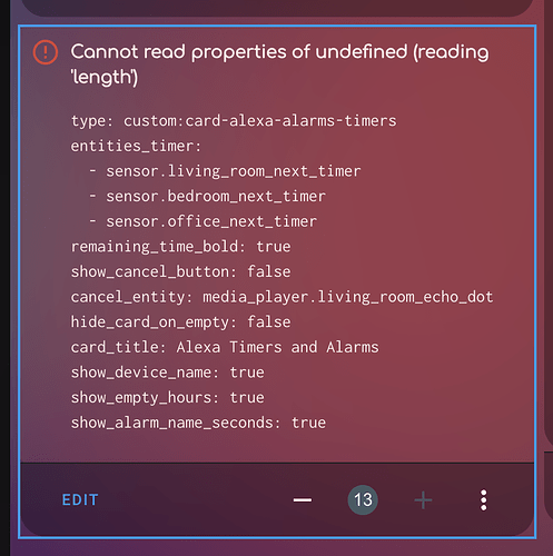

Amazing thanks @Kethlak !! I’ve tried the new card from the Github PR but unfortunately getting this error:
Edit: Just figured it out, I didn’t have the entities_alarm: defined. It works once I add the alarm sensors :partying_face:
