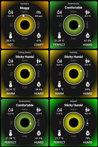

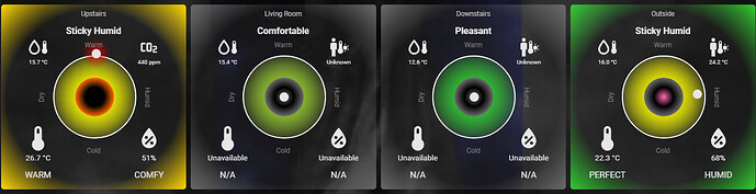

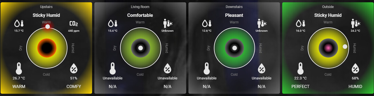

In the below image you can see the difference between my areas
  • Temperature Comfort Colour is the card background
  • Dewpoint Comfort Colour is the colour inside outer_ring:
  • Top Right Sensor is DewPoint
  • Top Left is Feels Like
you can add as much as you want. I have one for each room and one for outside.
Well that might be a good solution then. Do your cards look like above?
i try to find the right entities. Cards look similar, but no colors, no idea why, even not, if i add an else part with crimson color.

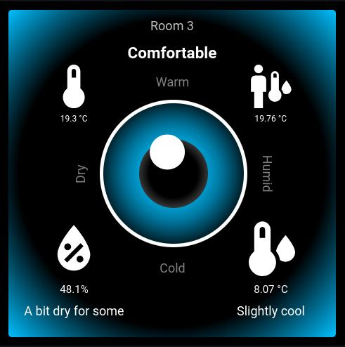

I would like to tint the white dot orange if there is mold risk, but i couldn’t find out how to change the dot color.
I am not sure if i need the dew point temperature. I may switch it with the difference between absolute humidity in- and outside.

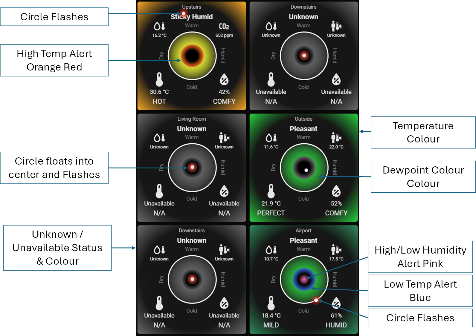

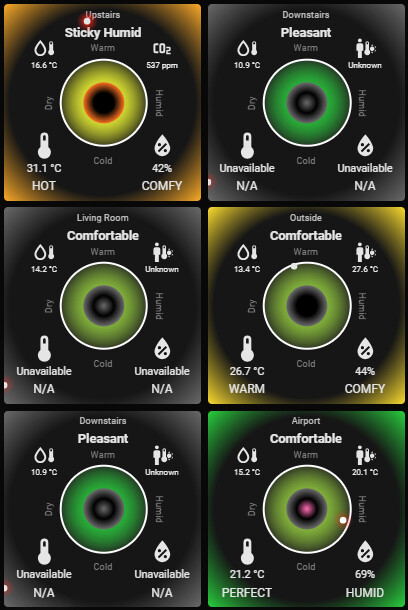

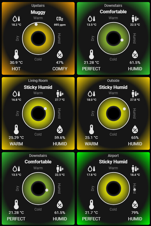

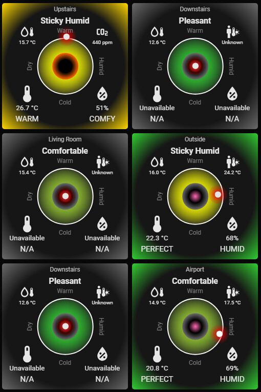

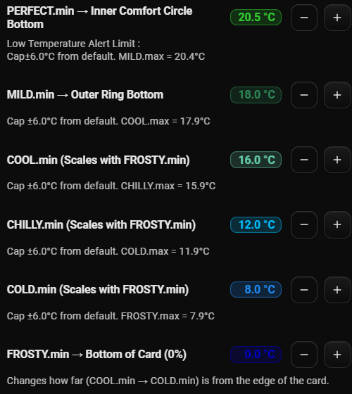

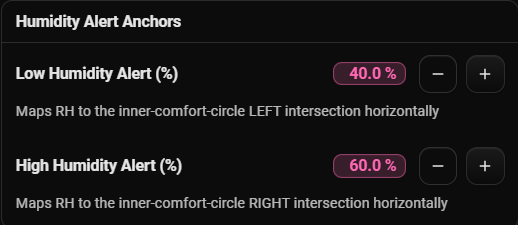

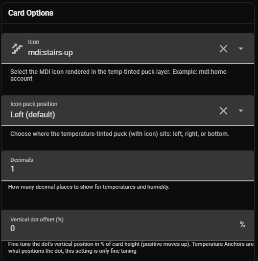

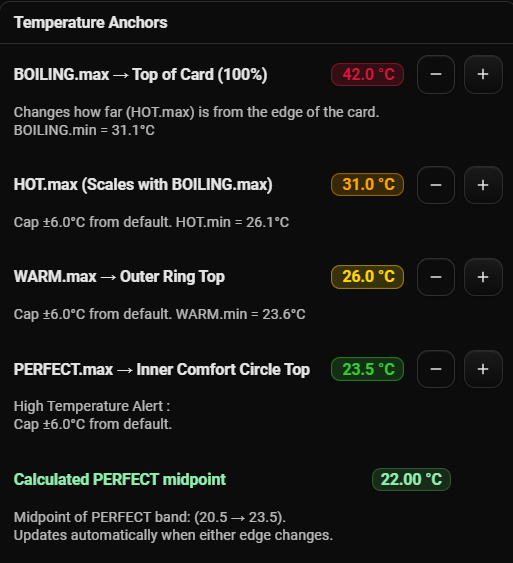

V5.0 SIMPLE AIR COMFORT CARD
Horizontal Stack
Two Vertical Stacks within Horizontal Stack
  • Fully refactored code
    • One card code for all screen sizes
    • No NodeRED Dependency
    • Minimal card-mod used (improves loading times)
    • Previous card-mod code moved into button card native
    • All border and background transparent
    • Default white icons
    • Error handling for unknown and unavailable sensors (text and colour)
    • Improved scaling for (Floating Circle)
  • Macro Driven
    • Most of the configuration of the card completed from the macro
    • Calculates Dewpoint
    • Calculates Feels like Temperature (Australian Apparent Temperature)
    • Calculates Temperature Colour (Card Background)
    • Calculates Dewpoint Colour (Outer Ring Limits)
    • Calculates Temp and Humidity Alert Colour (Inner Circle Comfort Zone)
    • Calculates Temperature and Humidity Position and Blinking Warning (Floating Circle)
    • Configurable setpoints in the macros, to allow customisation.
  • Sensors that get inserted into the card
    • Dewpoint
    • Feels like Temperature (Australian Apparent Temperature)
    • Temperature Colour (Card Background)
    • Dewpoint Colour (Outer Ring Limits)
    • Temp and Humidity Alert Colour (Inner Circle Comfort Zone)
    • Temperature and Humidity Position and Blinking Warning (Floating Circle)
Background Overlay

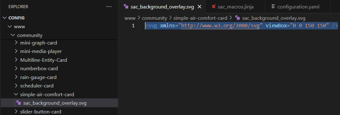

  1. Using Visual Studio Code Editor or other, create a new folder called simple-air-comfort-card in config/www/community
  2. Right Click on you newly created folder /config/www/community/simple-air-comfort-card and select New File
  3. Name the new file sac_background_overlay.svg
  4. Click on the file and paste the following:
  5. <svg xmlns="http://www.w3.org/2000/svg" viewBox="0 0 150 150" />

V5.1 SIMPLE AIR COMFORT CARD
  • Increased floating circle to 20px size
  • Improved centering of flashing red, moved into card-mod css, from custom button card.
  • Flashing starts when floating circle breaches top of outer ring limits 26.5
  • High Temp Alert when floating circle breaches top of outer ring limits 26.5
  • Default center temperature 22
Horizontal Stack
  • Macro Driven
    • Dewpoint
Background Overlay

Thanks @LiQuid_cOOled for the input and @vajdum, may be of interest to you.
FINALLY V5.1 SIMPLE AIR COMFORT CARD
  1. Paste the following code into your lovelace dashboard view
  2. Only thing that needs to be changed is the word living_room to suit your needs, also add your temperature and humidity sensors.
  3. Any sensors that start with sensor.sac are calculated in the Macro.

I have actually created a repo for it now.
Still needs some final polish but it is close. Yet to update readme with all functions in the card, I have made it like a room card now with a room icon.
Fully editable in the GUI editor and recommended way to setup.
FUNCTIONS IN THE UI EDITOR
Card Title
Temperature Entity
Temperature Display Unit
Temperature Anchors
Temperature Comfort Scale
Anchor Cap
Humidity Entity
Humidity Alert Anchors
Feels Like Formula
Windspeed Entity
Wind Display Unit
Card Options
