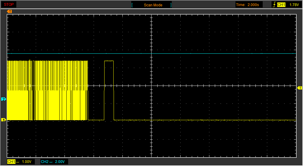

I got another probe on the VDD but this scope is REALLY crappy and I can’t really zoom into it too much vertically since the base of the signal must be displayed in the scope window. Anyway, this is a zoomed out view (2 seconds/DIV) and the failure happened just to the left of when the high-speed pulses stopped.
Here’s another one with the max voltage scaling that I can apply before the stupid waveform goes off the top of the screen. VDD looks okay.
Wow, it’s getting even better… :open_mouth:

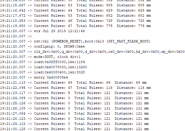

I took that code, compiled it on the Arduino IDE and sent it to the device. It isn’t great but it definitely shows pulses and a total in the Arduino Serial Monitor. However, after hand cranking it for about a minute, I can get the thing to reboot, just like it does with ESPHome:
I am at a loss here.
