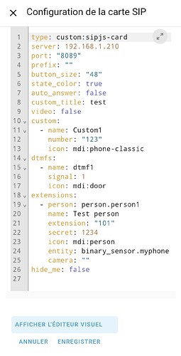

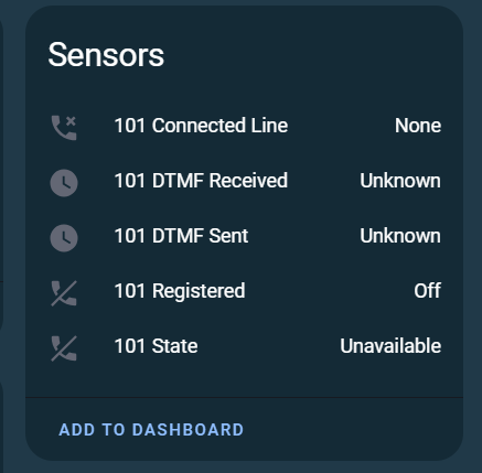

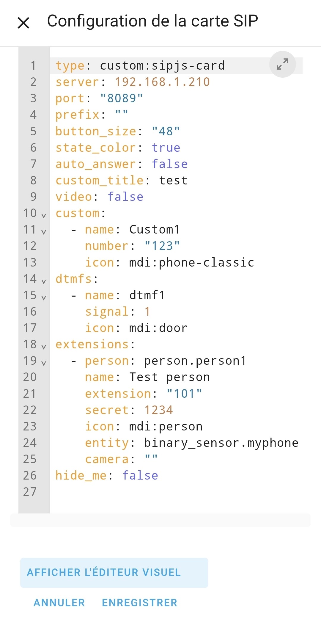

I found my problems. Nothing happened because i wasn’t in https. I migrate to https environment and works like a charm. Alternatively i was able to make a call in http environment with this Chrome flag: chrome://flags/#unsafely-treat-insecure-origin-as-secure
Unfortunately, I also face the same issue.
How exactly have you guys solved it?
