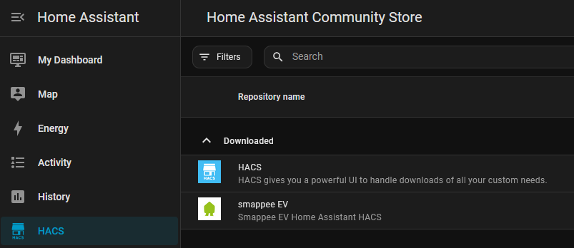

I just started working with Home Assistant and I added the smappee EV through HACS.
But I don’t see where I can configure it. It will be something stupid but I don’t see it.
Could you help out?
After installing it, you need to go to settings => devices and services and then add a new integration and choose Smappee EV.
