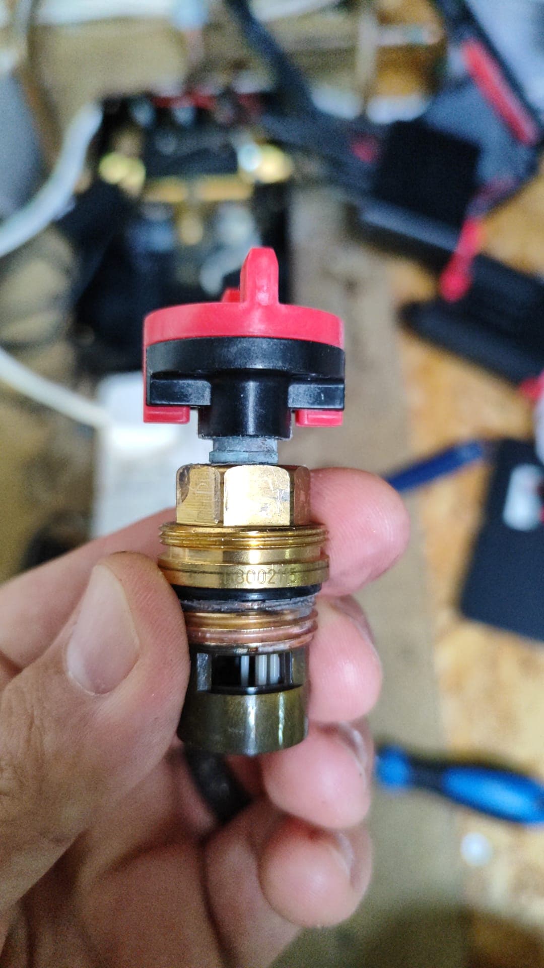

Perhaps someone here knows - I have a leak, havent had plumber look at it yet but think it might be in the control box.
Current setup is 3 outlet, with one on the bath
If i replace the control box is there any way to even set it up, and change the setup to match my physical layout? (i think the default is NOT what I currently have)
Also any way to change the default temps etc?
I don’t want to double down on a dead system but equally would be looking for a quick fix
Thanks
Also, if anyone has any spares, i’d be interested in buying for a reasonable amount - i think i might be able to fix in place
Okay, well thankfully fixed it - posting here in case it helps anyone, but sourcing the valves was pretty difficult after some trial and error
I found that HVT-Q153L from tapmagician while not identical fit the body and the motors, so if you find yourself needing to replace this is the one
