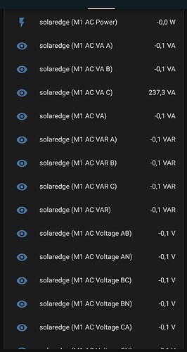

Hello everyone,
I recently installed the Solaredge Modbus integration and enabled Modbus TCP on the inverter (SE10K).
Connected to the IP address and correct port, but I only receive partial sensor data.
I can see current production, but not current usage, import and export…
Most M1 sensor data shows -0,1
Is there anything else I need to configure to show the correct M1 data, and to show current use, import/export?
Thanks in advance for any help.

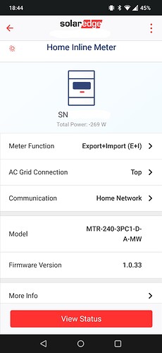

This is my connected meter:
That doesn’t look like my integration, so I can’t say.

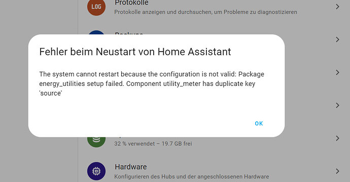

sorry for my bad english… Great work, almost everything works!
But when i try restart Hass it wont work. A error pop up. Some weeks ago i didnt have any problems.
Any idea?
Thx!
