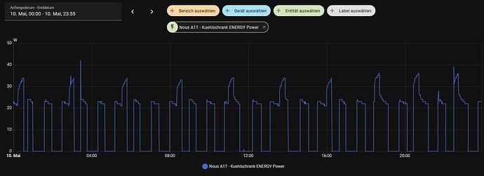

Regarding to the energy dashboard, my fridge (“Kühlschrank” in german) “produces” energy every now and then. Of course i use an accumulating sensor entity, it shows daily consumption in “kWh”. How can an accumulating energy decreasing? I mean, a fridge usually doesn’t “produce” energy.
I have not a single energy production entity in my environment yet. Except the fridge of course! ;-))
In case that matters: my frigde is connected with a Tasmota smart plug “Nous A1T”. Maybe the issue isn’t caused by HA, it could be also caused by some weird readings from that plug? When you buy that device, you need to calibrate it befrore using it. I’ve done that of course. Most of the time the readings seem okay, but then this happens every now and then…

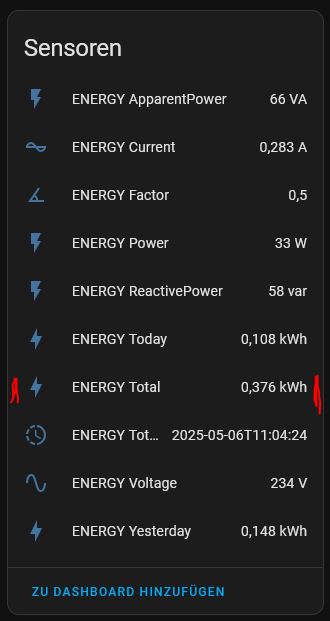

The plug provides this data:
For the energy dashboard i use the “energy total” entity.

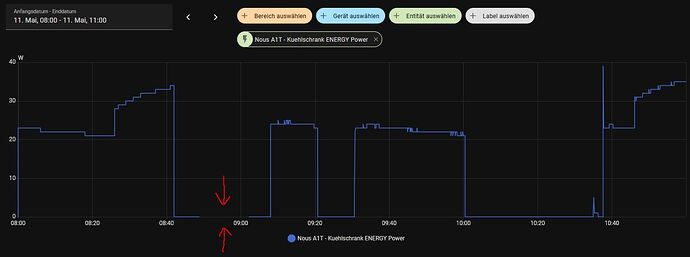

This is from today:
For comparison yesterday:
Regards
Sven
I have the same issue with the Nous A1T. The reason is simple and very annoying: The A1T forgets all counters on power loss and restarts with zero. Not good for a meter.
EDIT:
The state_class of the counter must be total_increasing. With this state_class a counter reset is handled correctly.
Replacing the “ENERGY Total” counters by “ENERGY Today” solves the issue for me.

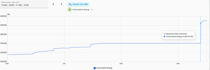

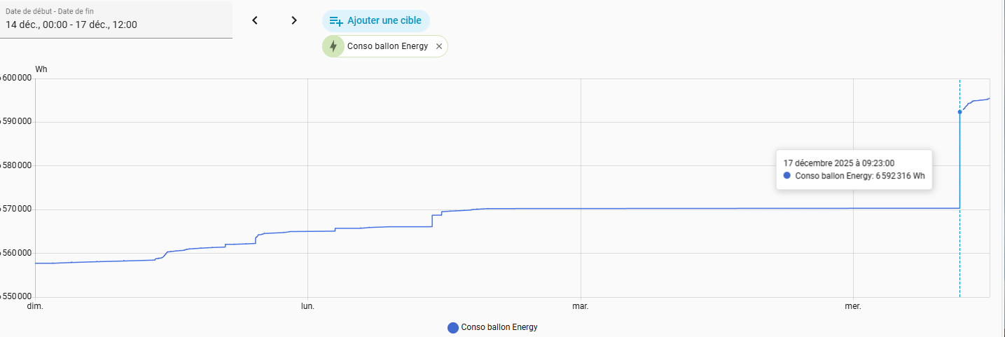

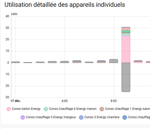

I have identified a cause of negative values in my dashboard.
I have an esp collecting the total consumption of the house through my energy provider counter.
I also monitor some devices in the house through an ESP and pzem-004t devices. So on the dashboard i have some detail and a big untracked gray part cumulating everything I don’t monitor separately.
When the consumption on my water heater stopped reporting data for 3 days, homeassistant puts its consumption into the untracked part. However 3 days later when the water heater esp finally sent its counter the gap between the previsous number and the new one appeared and is compensated with a negative number by homeassistant because otherwise it does not fit with the global counter from the provider.
hope it can help to understand some negative values.
I don’t know however how to avoid this. (maybe using some daily accumulative counters instead of infinites ones ?)
