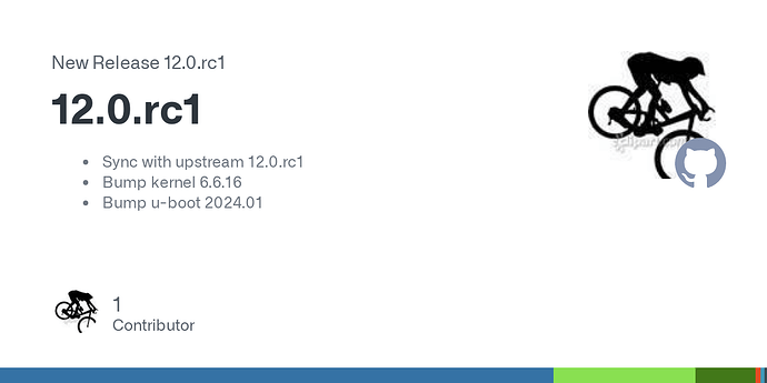

Checkout Odroid M1S also, I’ve just added support for this board to official HAOS and is available in 12.0rc1 ![]()

Synced with upstream HAOS. New release is available.

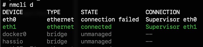

Looks like I’m one of the “lucky” guys who received a unit with faulty ethernet. My ihost just stoped working, I already contacted Sonoff support, but decided to try one last thing:
…and I’m really surprised that it worked out of the box! No config necessary, the system recognized the USB ethernet adapter and configured it automatically. Now my Home Assistant is back online!
Well, this kind of work, but Supervisor is having a weird behavior. I noticed CPU usage is ramping up to 80% all the time (usually it will stay around 6-10% when idle). The system eventually freezes and turn off randomly.
I plugged in to my PC and via USB terminal, I noticed NetworkManager is eating up the CPU. I suspect it keeps trying to manage the onboard eth0. So I tried doing this:
nmcli dev set eth0 managed no
This seem to fix it, CPU usage drops bellow normal load immediately. The problem is, if I restart the device, The problem is back.
My question is, How can I disable the onboard interface permanently so NetworkManager won’t go crazy again?

Anyway, I found another solution using nmcli. I hope this can be useful to other people.
Use
nmcli conto list the connection names, in my case the connection configured to the onboard ethernet port (eth0) was named asWired connection 1. It can also be something likeSupervisor eth0. -
Edit the connection:
nmcli con edit 'Wired connection 1'
- Use
setto change these properties:
nmcli> set connection.autoconnect no
nmcli> set ipv4.method disabled
nmcli> set ipv6.method disabled
- Then save, and reboot the system.
nmcli> save persistent
