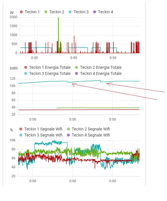

I have a small issue with sonoff plugs (flashed with tasmota). I was trying to collect data over time in order to calculate the overall energy consumption and costs. The problem is that the total energy sensor behaviour is strange since it is not monotonus (always increasing), as you can see in the attached picture. Maybe this is due to some wifi signal drop, since the wifi signal shows drops at the position of the total energy drop. Maybe I missed some useful information concerning this. Anyway do you have some advises in order to solve this problem? Thank you
