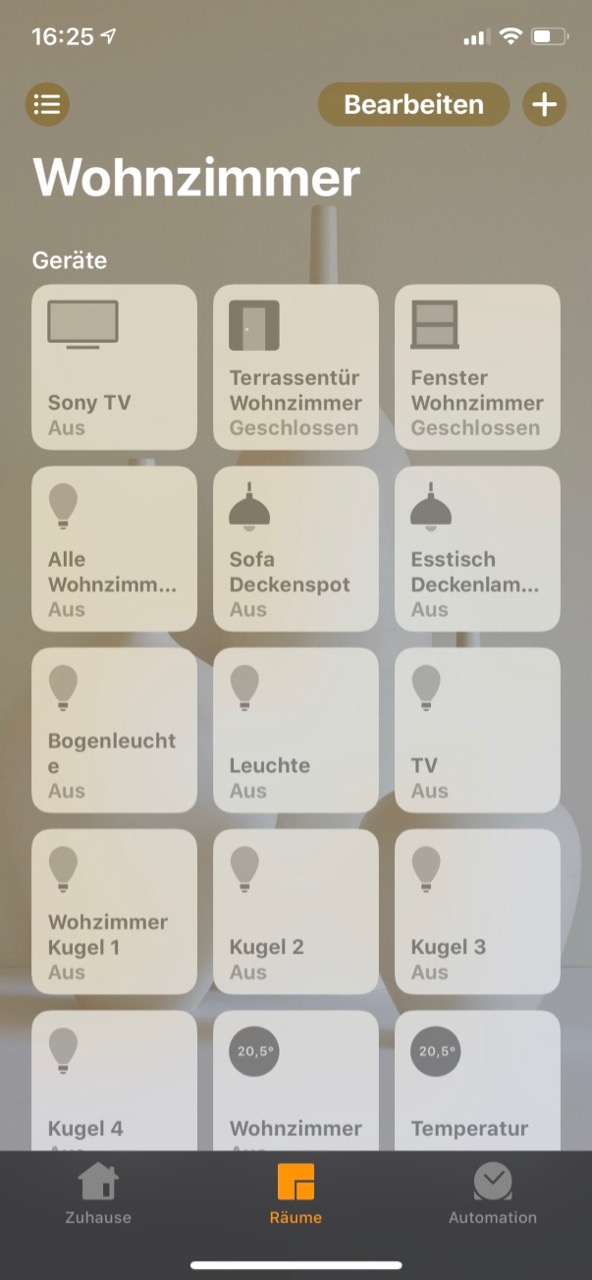

At the moment the TV is exposed as Switch. But now you can use HomeKit as an Remote.
„ media_player TelevisionMediaPlayer All media players that have tv as their device_class . Represented as Television and Remote accessories in HomeKit to control on / off , play / pause , select source , or volume increase / decrease , depending on supported_features of entity. Requires iOS 12.2/macOS 10.14.4 or later.“

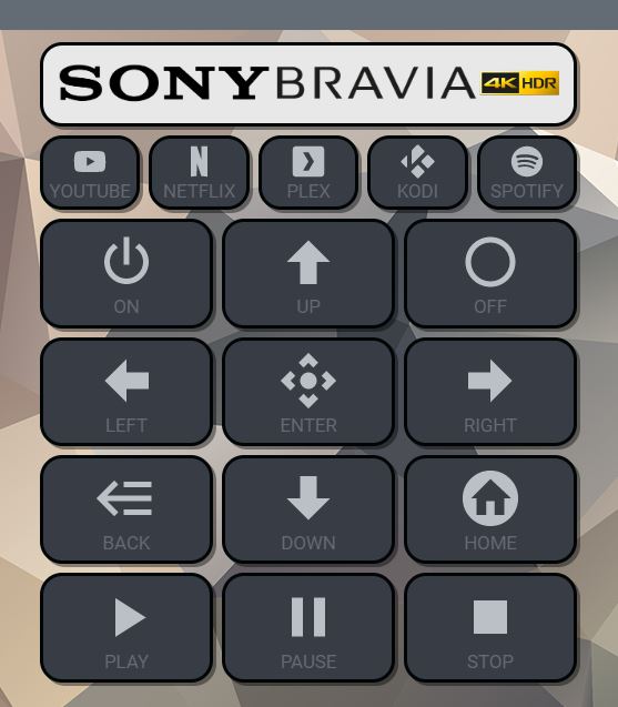

I decided yesterday to add the TV again as a generic Android TV, I then modified the code by mcfrojd to create tthe below remote.
Next step for me is to make a few scripts using this to then integrate with your mini media player lovelace card.

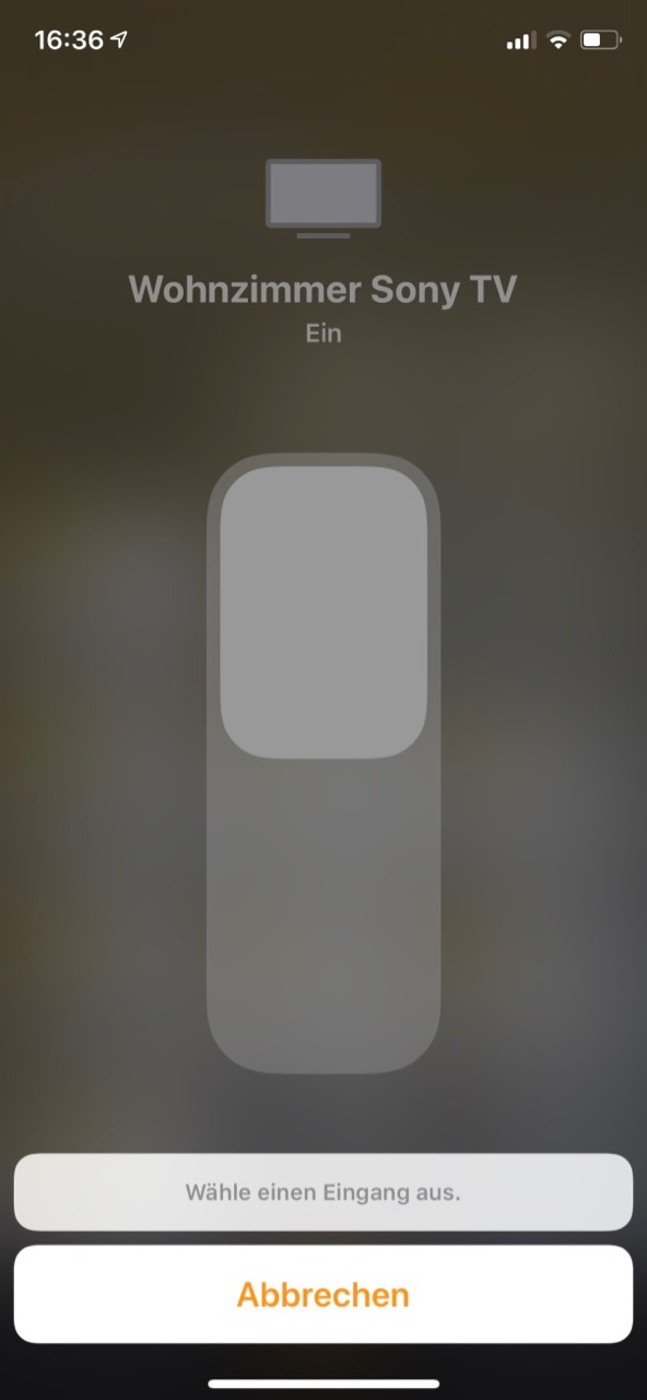

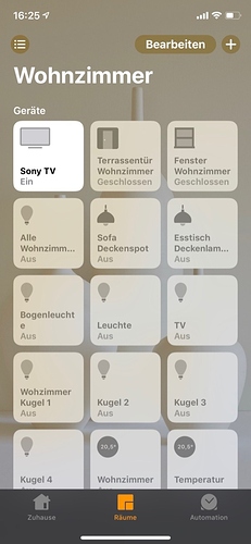

I’ve tested and confirm that it’s working. But I can not select the source. Do I need some configuration? In Home Assistant I can change the source.
Edit: Now I can see the sources. I don’t really know what happend. Maybe it is because I re-configured HomeKit.
Cool! Did you need to do anything in Homekit to make it work? Like removing the old entities?
I did remove the old entitties, restarted HA, add the new entitty and then it just works.
BUT you should care about your sources. If you don’t have any filters, you will have to much sources and HomeKit (or HA) has some issues with it. Maybe it is because of die 100 Device Limit? I am not sure. But I had to filter my sources to an minimum. But I guess, this is nothing for your component.
