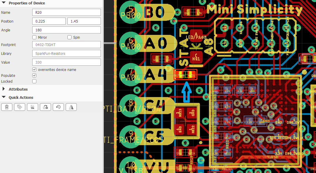

Got it working in the end, recording this here for other folks who might find themselves in the same situation.
I suspected that the J-Link OB serial port (what’s exposed through the USB-C connector) could be the issue here, a few mentions of problems with higher baud rates. Bypassed it by popping off R20 on the board:
…and connected a CP2104 UART to pins A5 (TX on Thing Plus, RX on CP2104) and A6 (RX on Thing Plus, TX on CP2104). Still powering the board through the USB-C connector.
Everything works as expected now, using the mgm240p_openthread_rcp_2.5.3.0_GitHub-1fceb225b_gsdk_2024.6.3_no_flow_460800.gbl from Release 20250627 · darkxst/silabs-firmware-builder · GitHub
There is a chance this could also work without the R20 rework, and with the higher baudrate firmware, but I was fed up enough that I did not try them out and probably won’t touch this for a while now that it is working.
