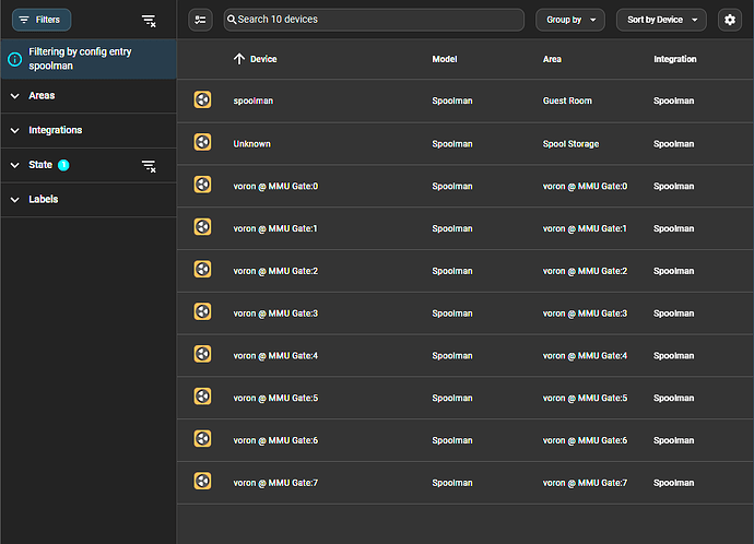

Hey @Disane87 , I just found your integration and set it up. I’m really digging spoolman and I love Home Assistant so this is the perfect marriage! I have an Enraged Rabbit Carrot Feeder (ERCF or more simply a single extruder, multi-filament changer). I think it’s causing some problems with the integration. The guy who writes the software for the ERCF (MoggieUK) created a mechanism to automatically update the spoolman entry on the printer when the filaments get swapped during a print. There are 8 ā€œtoolsā€ on my printer because I have an 8-way ERCF and I’m wondering if it is working as intended.

After installing the integration it created devices and areas for each one of the locations in spoolman along with a ā€œspoolmanā€ and ā€œUnknownā€ device:
  • When I look at the first ā€œspoolmanā€ device, it has the spool_id #14 - glow in the dark green.
  • When I look at the second ā€œUnknownā€ device, it lists all the spools that have not yet been used with spoolman.
  • When I look at each remaining klipper tool device it contains the spool loaded into that tool.
Is this how it is supposed to work?

Thank you for your kind words @SpikeyGG! Yeah that seem to be working as intended since every location in Spoolman will create a device in HA with spools as entities. The intention of this was to recreate the physical locations of the spools (like a long term storage or drybox). Unfortunately this practice has some flaws and changing a location in spoolman needs a reload of the integration. In one of the next release I will change that.
