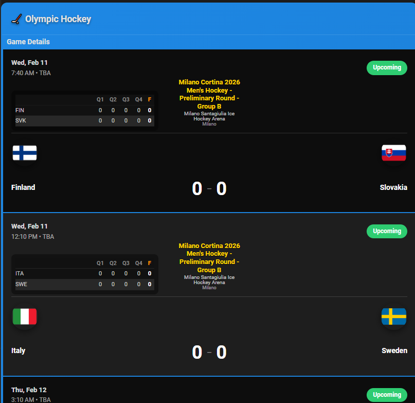

Running it through my sports_playoffsv5_withsquarterscores: decluttering template I got this:
but as you can see it is using the football layout. So I sent the decluttering card through Chatgpt and it gave me this:

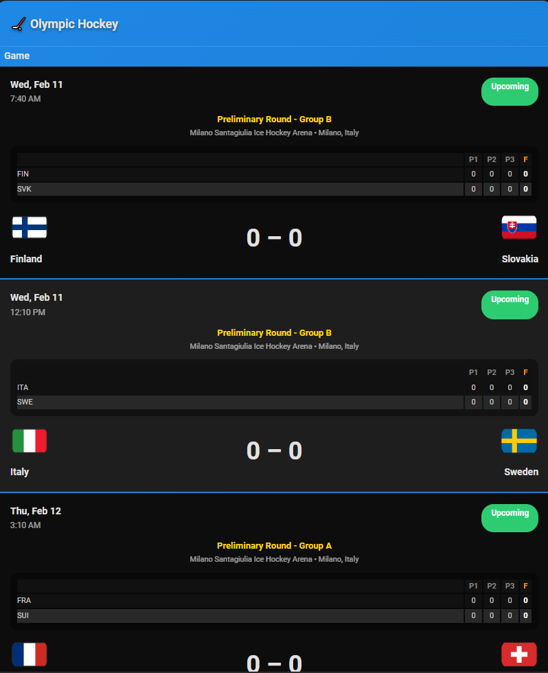

sports_olympic_hockey_v1:
card:
type: custom:flex-table-card
title: '[[title]]'
css:
table+: padding:0;width:100%;
tbody tr td:first-child: width:100%;padding:0;border:none;
tbody tr:hover: background-color:rgba(255,255,255,0.05)!important;
tbody tr: border-bottom:1px solid rgba(255,255,255,0.08);
card_mod:
style:
ha-card {
overflow: hidden;
border: 2px solid [[color]];
border-radius: 14px;
background: linear-gradient(
135deg,
[[color]] 0%,
color-mix(in oklab, [[color]], black 22%) 100%
@keyframes scroll {
0% { transform: translateX(0%); }
100% { transform: translateX(-50%); }
.card-header {
background: transparent;
color: white;
padding: 14px 18px !important;
font-size: 18px !important;
font-weight: bold !important;
text-shadow: 0 2px 4px rgba(0,0,0,0.4);
border-bottom: 1px solid rgba(255,255,255,0.12);
sort_by: Date
entities:
include: '[[entity]]'
columns:
- name: ID
data: '[[events]]'
modify: x.competitions[0].id
hidden: true
- name: Date
data: '[[events]]'
modify: x.competitions[0].date
hidden: true
- name: Game
data: '[[events]]'
modify: |-
if (!x?.competitions?.[0]) return "No data";
const c = x.competitions[0];
/* Dates */
const gameDate = new Date(c.date).toLocaleDateString("en-US",
{ weekday:"short", month:"short", day:"numeric" });
const gameTime = new Date(c.date).toLocaleTimeString("en-US",
{ hour:"numeric", minute:"2-digit", hour12:true });
/* Teams */
const competitors = c.competitors;
const home = competitors.find(t => t.homeAway === "home");
const away = competitors.find(t => t.homeAway === "away");
/* Venue */
const venue = c.venue?.fullName || "";
const city = c.venue?.address?.city || "";
const country = c.venue?.address?.country || "";
const location = [city, country].filter(Boolean).join(", ");
/* Round / Group */
let roundName = "";
if (c.notes?.[0]?.headline) {
roundName = c.notes[0].headline
.replace("Milano Cortina 2026 ", "")
.replace("Men's Hockey - ", "");
/* Status */
const state = c.status?.type?.state || "pre";
let statusBadge = "";
if (state === "post") {
statusBadge = `<div style="background:#fff;color:#000;
padding:4px 14px;border-radius:18px;font-size:12px;font-weight:bold;">
Final</div>`;
} else if (state === "pre") {
statusBadge = `<div style="background:#2ecc71;color:#fff;
Upcoming</div>`;
} else {
statusBadge = `
<div style="text-align:center;">
<div style="background:#c00;color:#fff;
padding:2px 10px;border-radius:12px;
font-size:10px;font-weight:bold;letter-spacing:1px;">
LIVE
</div>
<div style="margin-top:4px;font-size:13px;font-weight:bold;">
${c.status.displayClock}
<span style="font-size:11px;opacity:.7;">P${c.status.period}</span>
</div>
</div>`;
/* Hockey period grid (3) */
let awayP = ["0","0","0"];
let homeP = ["0","0","0"];
if (state !== "pre" && away.linescores?.length) {
for (let i = 0; i < 3; i++) {
if (away.linescores[i]) awayP[i] = away.linescores[i].displayValue || "0";
if (home.linescores[i]) homeP[i] = home.linescores[i].displayValue || "0";
const awayScore = state === "pre" ? "0" : away.score;
const homeScore = state === "pre" ? "0" : home.score;
const periodGrid = `
<div style="margin:8px 0;background:rgba(0,0,0,.4);
border-radius:10px;padding:8px;font-size:11px;">
<table style="width:100%;color:#ccc;">
<thead>
<tr style="text-align:center;color:#888;">
<th></th><th>P1</th><th>P2</th><th>P3</th>
<th style="color:#ff9800;">F</th>
</tr>
</thead>
<tbody>
<tr style="text-align:center;">
<td style="text-align:left;">${away.team.abbreviation}</td>
<td>${awayP[0]}</td><td>${awayP[1]}</td><td>${awayP[2]}</td>
<td style="color:#fff;font-weight:bold;">${awayScore}</td>
</tr>
<td style="text-align:left;">${home.team.abbreviation}</td>
<td>${homeP[0]}</td><td>${homeP[1]}</td><td>${homeP[2]}</td>
<td style="color:#fff;font-weight:bold;">${homeScore}</td>
</tr>
</tbody>
</table>
</div>`;
return `
<div style="padding:16px;background:rgba(0,0,0,.25);">
<div style="display:flex;justify-content:space-between;">
<div>
<div style="font-weight:600;">${gameDate}</div>
<div style="font-size:12px;opacity:.7;">
${gameTime}
</div>
</div>
${statusBadge}
</div>
${roundName ? `
<div style="text-align:center;margin:10px 0;">
<div style="color:#FFD700;font-weight:bold;font-size:13px;">
${roundName}
</div>
<div style="font-size:11px;opacity:.7;">
${venue} ⢠${location}
</div>
</div>` : ""}
${periodGrid}
<div style="display:flex;justify-content:space-between;align-items:center;">
<div style="flex:1;text-align:left;">
<img src="${away.team.logo}"
style="height:56px;border-radius:50%;">
<div style="font-weight:600;">${away.team.displayName}</div>
</div>
<div style="flex:1;text-align:center;font-size:36px;
font-weight:bold;">
${awayScore} ā ${homeScore}
</div>
<div style="flex:1;text-align:right;">
<img src="${home.team.logo}"
<div style="font-weight:600;">${home.team.displayName}</div>
</div>
</div>
</div>`;
I call like this:
- type: custom:decluttering-card
template: sports_olympic_hockey_v1
variables:
- title: š Olympic Hockey
- color: '#1e88e5'
- entity: >-
sensor.olympics_winter_hockey_filtered_events
- events: olympic_hockey
- show_rankings: true
- show_series: false
and I get this - probably more in line to what you are looking for:

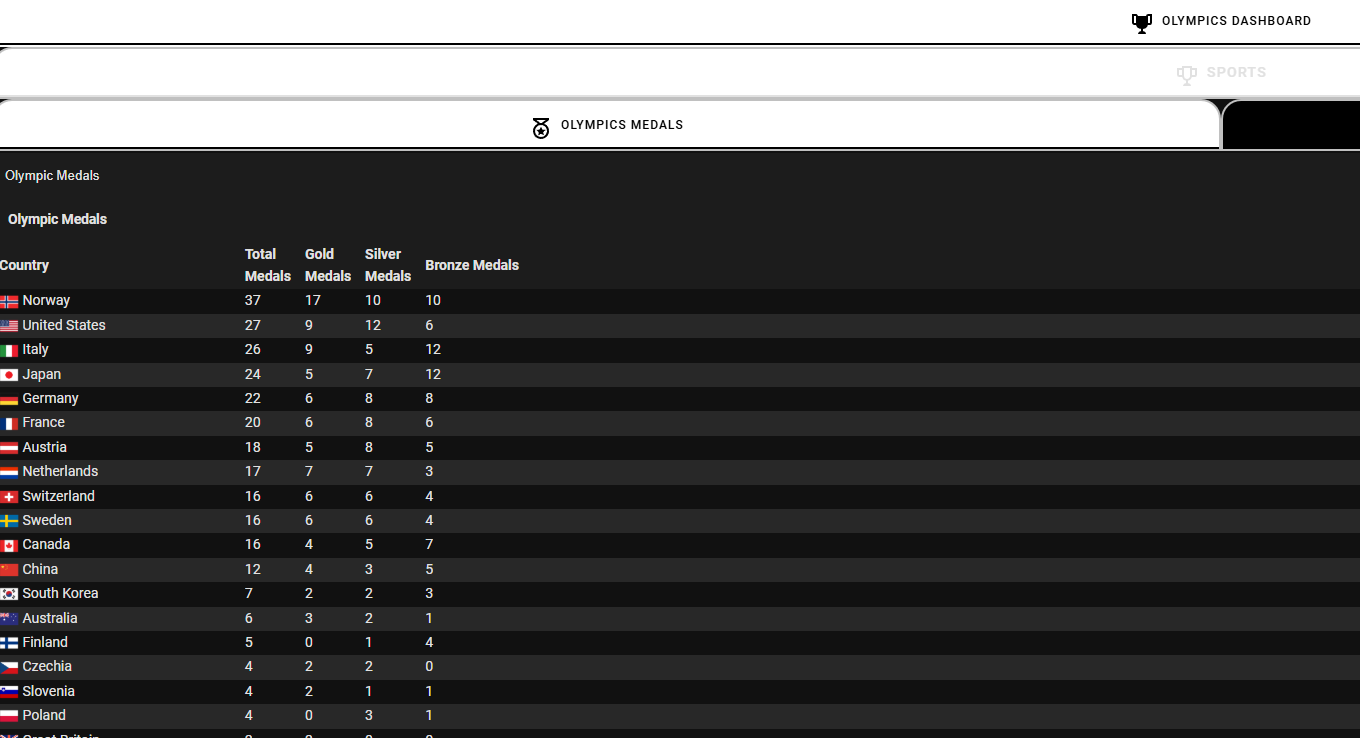

If you are looking for Medals here is the link that currently works (always a big thanks to ESPN for supporting (indirectly) our community)
I also have these 2 endpoints but not much info:
- https://site.web.api.espn.com/apis/site/v2/olympics/winter/2026/scoreboard
- https://site.web.api.espn.com/apis/site/v2/olympics/winter/2026/results

resource: https://site.web.api.espn.com/apis/site/v2/olympics/winter/2026/medals
value_template: "{{ now() }}"
json_attributes:
- medals
Hereās my basic medal decluttering card:
olympics_medals:
card:
title: '[[title]]'
css:
table+: 'padding: 0px; width: 100%;border-collapse: collapse; margin-top:12px;'
tbody tr td:first-child: 'width: 10%;'
tbody tr td:nth-child(2): 'width: 2%;'
tbody tr td:nth-child(3): 'width: 1%;'
tbody tr td:nth-child(4): 'width: 2%;'
tbody tr:hover: 'background-color: dimgrey!important; color:white!important;'
card_mod:
style:
ha-card {
overflow: auto;
.card-header {
padding-top: 6px!important;
padding-bottom: 4px!important;
font-size: 14px!important;
line-height: 14px!important;
font-weight: bold!important;
sort_by: Total Medals-
entities:
exclude: '[[excluded_entities]]'
columns:
- name: Country
data: '[[attribute]]'
modify: >-
'<div><img src="' + x.flag.href + '" style="height:
20px;vertical-align:middle;"> ' + x.name + '</div>'
- name: Total Medals
modify: x.medalStandings.totalMedals
- name: Gold Medals
modify: x.medalStandings.goldMedalCount
- name: Silver Medals
modify: x.medalStandings.silverMedalCount
- name: Bronze Medals
modify: x.medalStandings.bronzeMedalCount
How I call the card in the dashboard:
template: olympics_medals
variables:
- title: Olympic Medals
- entity: sensor.olympics_winter_medals
- attribute: medals
And you get this:

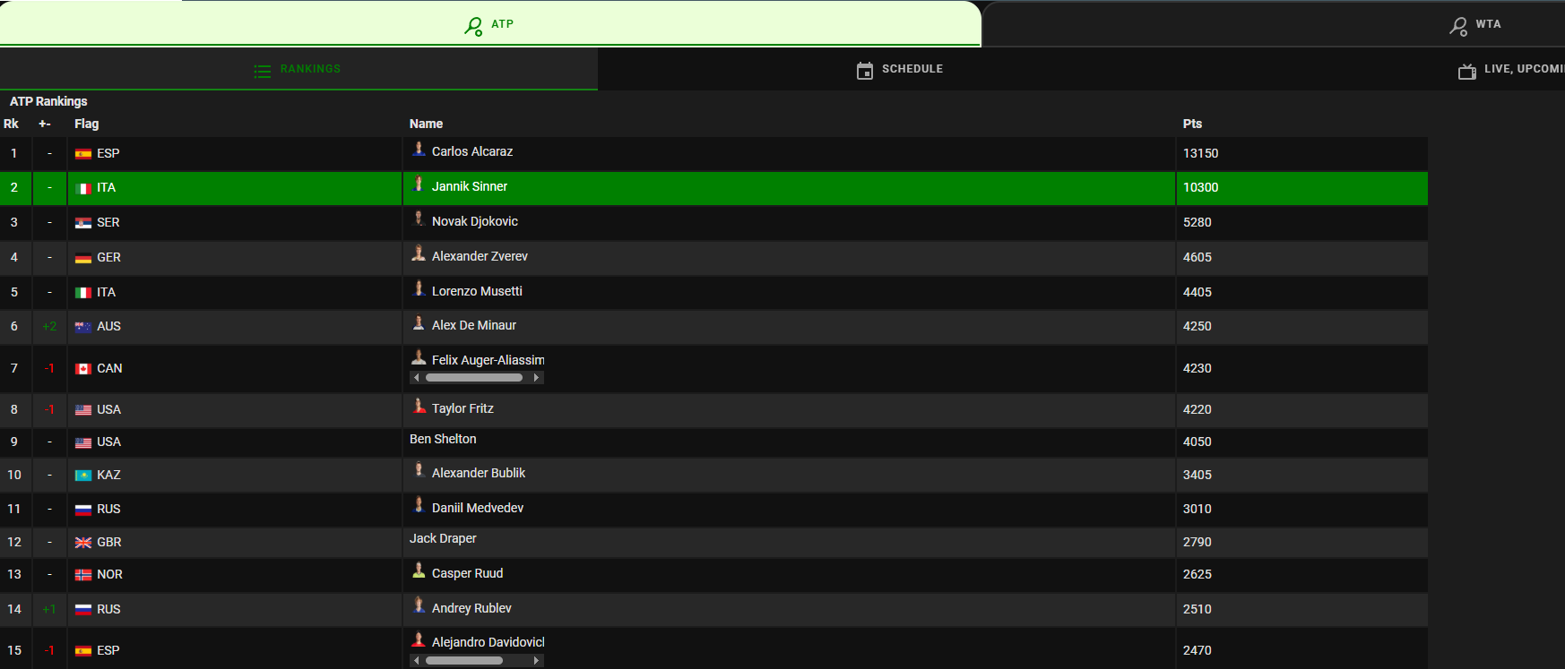

Is it possible to have an ATP menās tennis ranking?
I show this link gives me the ATP rankings:
https://site.web.api.espn.com/apis/site/v2/sports/tennis/atp/rankings?region=us&lang=en
To get to the ATP ranks in the link I dive into the rankings. So my sensor looks like this (you can find it in the tennis.yaml on my github)
- platform: rest
scan_interval: 36000
name: Tennis ATP Ranking
unique_id: sensor.tennis_atp_ranking
resource: https://site.web.api.espn.com/apis/site/v2/sports/tennis/atp/rankings?region=us&lang=en
json_attributes_path: "$.['rankings'][0]"
json_attributes:
- ranks
My decluttering card looks like this:
decluttering_templates:
ranking_settings:
card:
title: '[[title]]'
css:
table+: >-
padding: 0px; width: 100%; max-width: 1600px; display: block;
overflow-x: auto;
tbody tr td:first-child: 'width: 0.1%; text-align: center;'
tbody tr td:nth-child(2): 'width: 0.1%; text-align: center;'
tbody tr td:nth-child(3): 'width: auto; text-align: center;'
tbody tr td:nth-child(n+4): 'width: auto;'
tbody tr:hover: 'background-color: green!important; color: white!important;'
'@media (max-width: 600px)': |
tbody tr td {
font-size: 12px;
padding: 2px;
tbody tr td img {
width: 15px;
height: 15px;
card_mod:
style:
ha-card {
overflow: auto;
.card-header {
entities:
sort_by: ranks
columns:
- name: Rk
data: ranks
modify: x.current
- name: +-
data: ranks
modify: >-
'<div style="color:' + (x.trend > 0 ? 'green' : x.trend < 0 ? 'red'
: 'white') + ';">' + x.trend + '</div>'
- name: Flag
data: ranks
modify: >-
'<div style="white-space: nowrap; display: flex; align-items:
center;">' + (typeof x.athlete.flag !== 'undefined' ? '<img src="' +
x.athlete.flag + '"
style="width:20px;height:20px;margin-right:5px;">' : '') + '<span>'
+ x.athlete.citizenshipCountry + '</span></div>'
- name: Name
data: ranks
modify: >-
'<div style="white-space: nowrap; overflow: auto; max-width: 150px;
display: inline-block;">' + (typeof x.athlete.headshot !==
'undefined' ? '<img src="' + x.athlete.headshot + '"
(x.athlete.links && x.athlete.links.find(l =>
l.rel.includes("playercard")) ? '<a href="' + x.athlete.links.find(l
=> l.rel.includes("playercard")).href + '" target="_blank"
style="text-decoration: none; color: inherit;">' +
x.athlete.displayName + '</a>' : x.athlete.displayName) + '</div>'
- name: Pts
data: ranks
modify: x.points
And I call it like this:
card:
template: ranking_settings
variables:
- title: ATP Rankings
- entity: sensor.tennis_atp_ranking
And I get this:
Hope that helps.

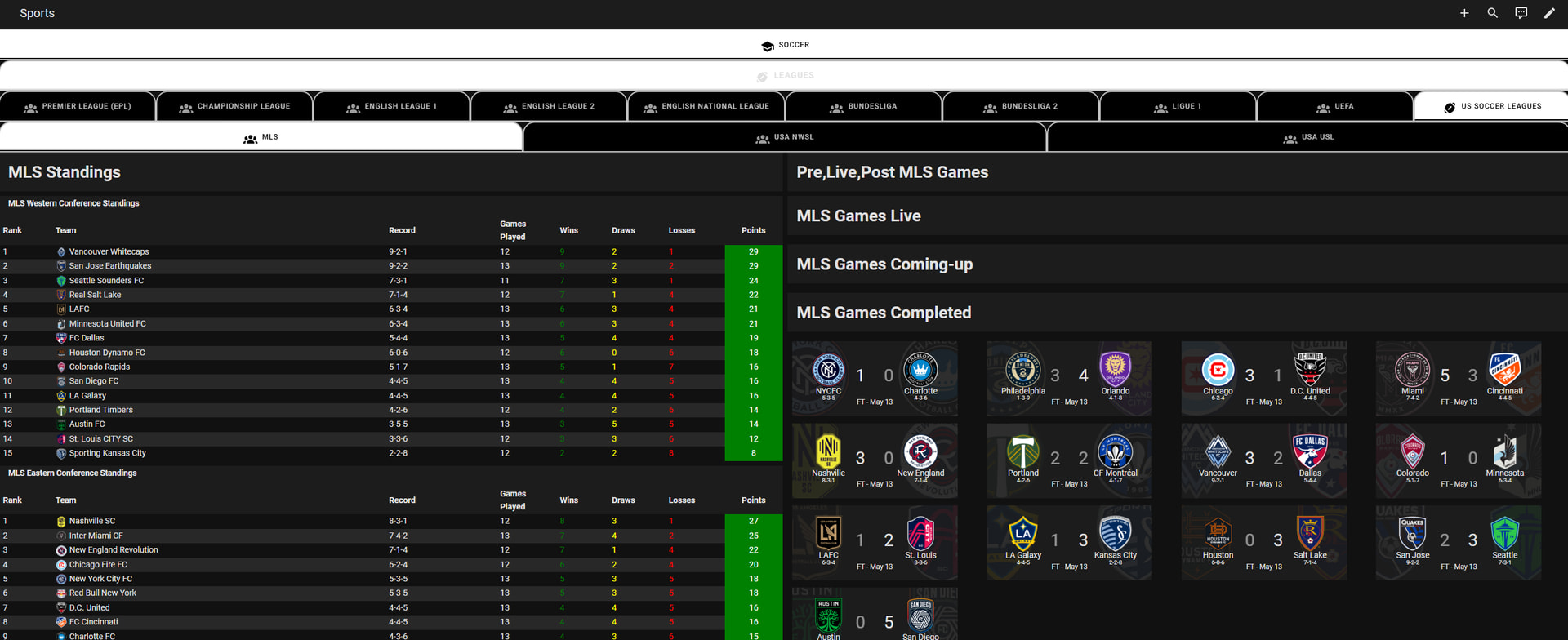

Cool - glad it worked. Not sure if you saw my github but I have a mostly complete layout of soccer - (mostly majors). Sensors, templates, dashboard - all should be up there
Link is here: https://github.com/bburwell/HA-Sports-Scores
Soccer dashboard is here:
https://github.com/bburwell/HA-Sports-Scores/blob/c5a6afb093e397668dbe4aab29c7ec27575b827e/Dashboards/Sports_Soccer
Looks like this:

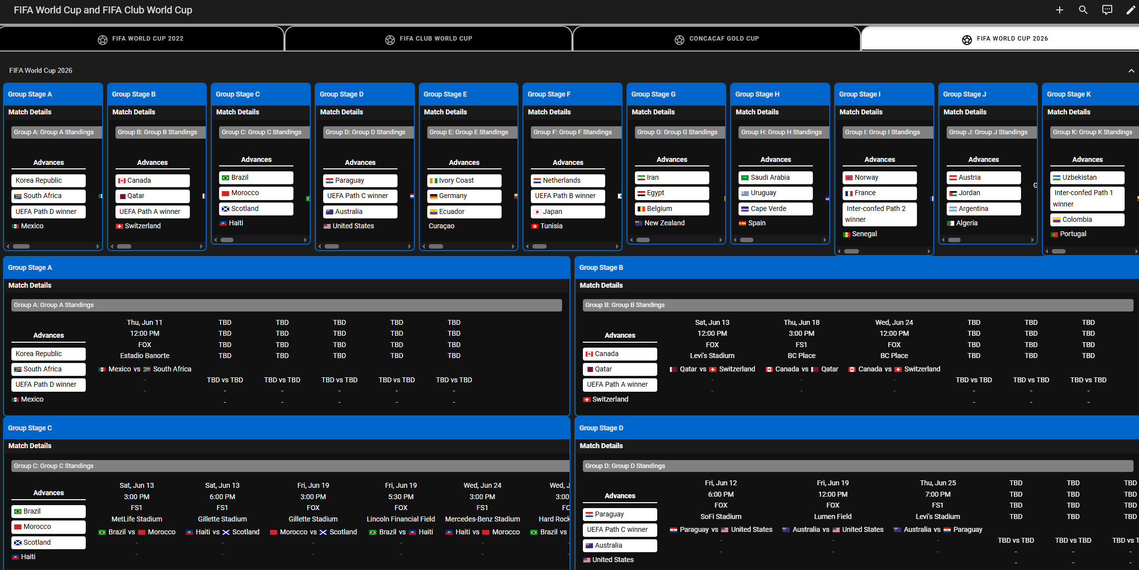

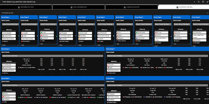

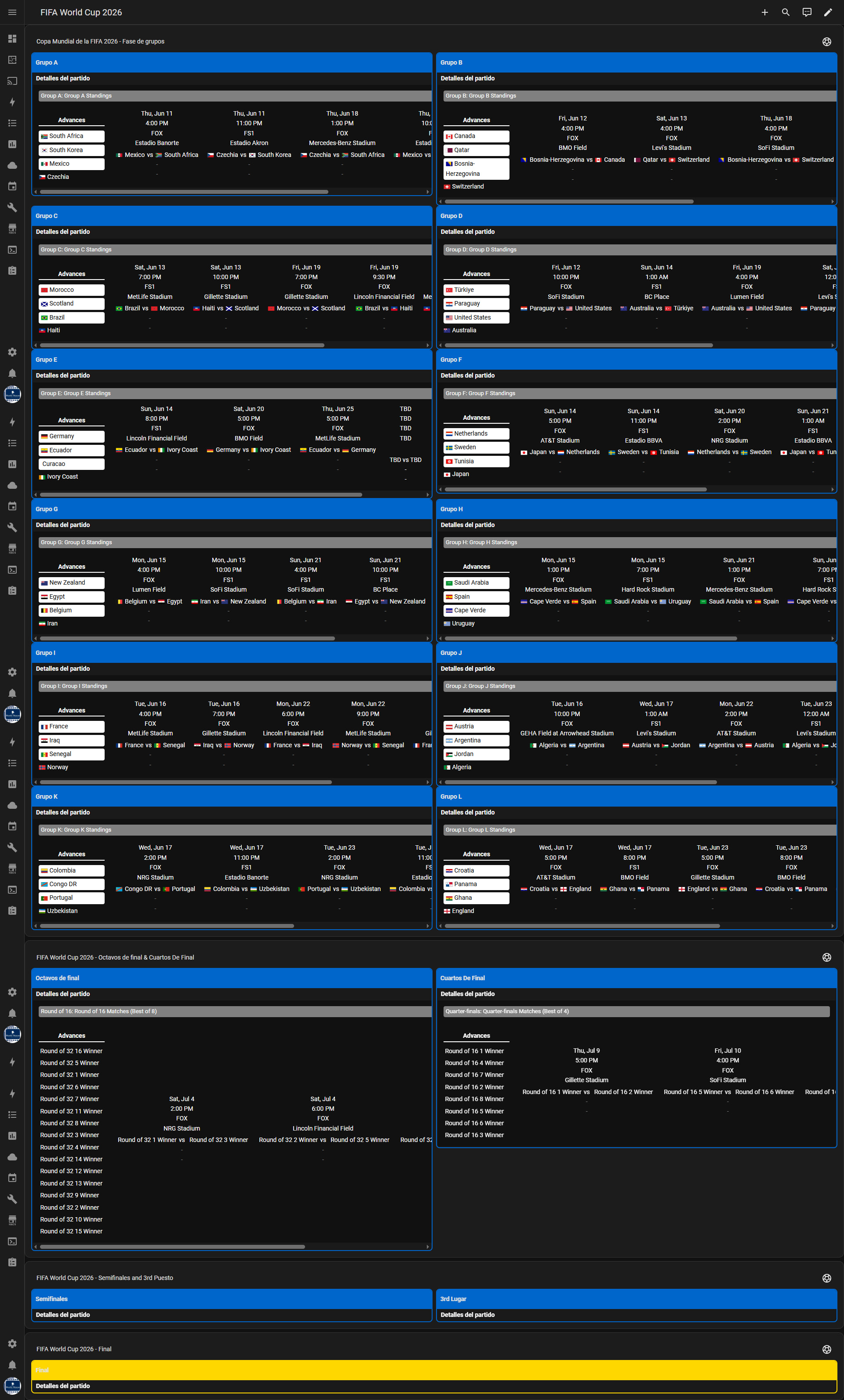

Can something like this be done for all the World Cup 2026 matches?
I'll be honest I haven't gone through and cleaned this up but there are some sections up on my github that should get you what you are looking for or at least give you a start. Mostly based on the 2022 WorldCup.
Dashboard is here: HA-Sports-Scores/Dashboards/Soccer - FIFA World Cup and FIFA Club World Cup at 3549be9d0cbaf7b3bd58c6489242179a490bfb66 Ā· bburwell/HA-Sports-Scores Ā· GitHub
Python Script is here: HA-Sports-Scores/Python Files/fifa_worldcup.py at 3549be9d0cbaf7b3bd58c6489242179a490bfb66 Ā· bburwell/HA-Sports-Scores Ā· GitHub
Soccer Sensors are here: HA-Sports-Scores/sensors/soccer_sensors.yaml at 3549be9d0cbaf7b3bd58c6489242179a490bfb66 Ā· bburwell/HA-Sports-Scores Ā· GitHub
You will need to add the python call to the configuration.yaml ( get_fifa_worldcup: 'python /config/www/fifa_worldcup.py') I have an example in github and setup an automation to call the python so it can separate the matches into json files that the sensors then import. It follows the same path as I do for most Tournaments/CFP/etc.
You should see this - caveat I have not started cleaning this up so pieces my be wrong or don't work. Let me know if you run into something and I can try to update.
Thanks, during the week Iāll try to implement it, and Iāll let you know if I manage to do it! Many thanks

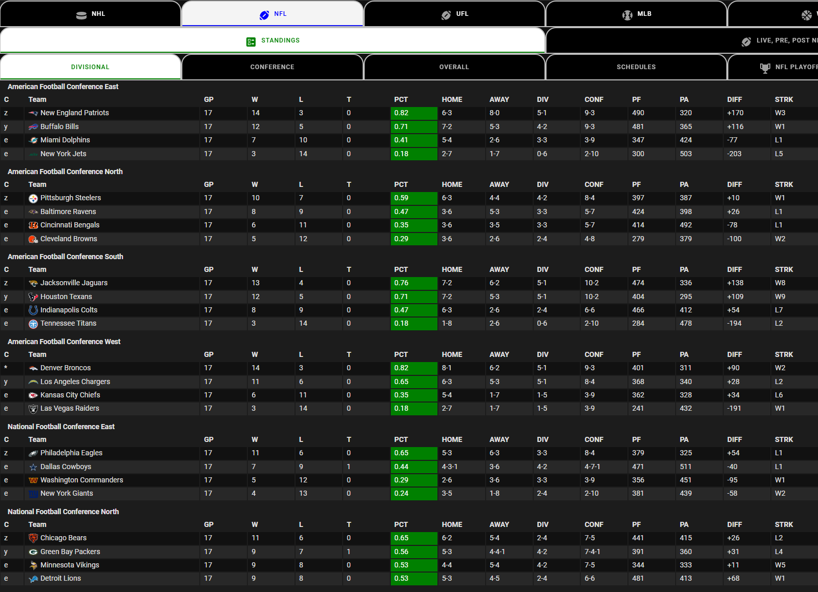

I am looking to simply have the NFL Standings. Trying to clip that out and use it but this is getting to be a bit more complicated than I expected. Some of the plugins are 7+ years old. Isn't there an updated way to just simply see the NFL standings on a dashboard either solo or as a card?
That is what I am trying to do. Which setup guide did you use? I understand some of the pieces required are now native to HA and don't need to be installed like decluttering. Maybe I am reading it wrong.
It all started with @kbrown01 design and then some of us added to his concept.
He lays out what he did at the top of this thread and I try to cover what I did at my github site here: GitHub - bburwell/HA-Sports-Scores: Home Assistant Sports Scores, Standings, Dashboards and Yaml's for Home Assistant Ā· GitHub
Basically we pull data from ESPN Open API's, put the data in sensors, utilize Flex-table, Team Tracker, Card-mod etc to deliver the dashboards.
I use Python to put some of the data in sensors, some grab data from other API's/Sites, some just use Team-Tracker, some use the F1, mostly just for fun.
This thread has a lot of detail/data that should help you get started. My site has a bit of a write-up plus dashboards, sensors, templates, python files, etc. that may help you as well.
Have fun!
