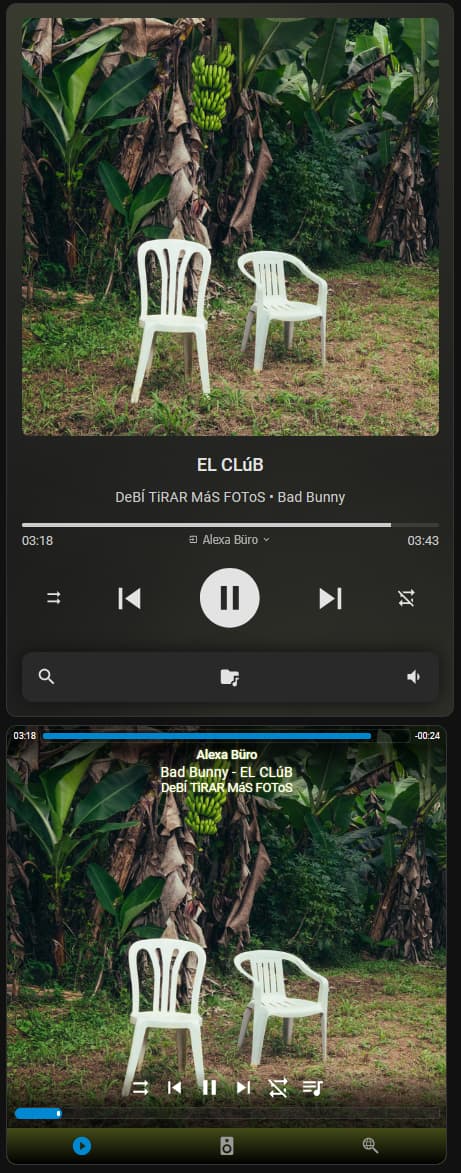

I’ve been playing around with the integration a bit today and there’s one thing I’m not entirely happy with (or maybe I’m just not tech-savvy enough).
I want to use the integration together with the “Mediocre Massive Media Player” card because I think the design is a bit nicer than the SpotifyPlus card.
Everything works with the Mediocre Massive Media Player card and the SpotifyPlus integration except for the search function. Is it possible to get the search function to work with the card and the integration, or is it necessary to use the SpotifyPlus card for searching?
If it’s not possible, I would appreciate any tips on how I can design the SpotifyPlus card to be similar to the Mediocre Massive Media Player card.
Top is Mediocre Massive Media Player card and bottom is SpotifyPlus Card

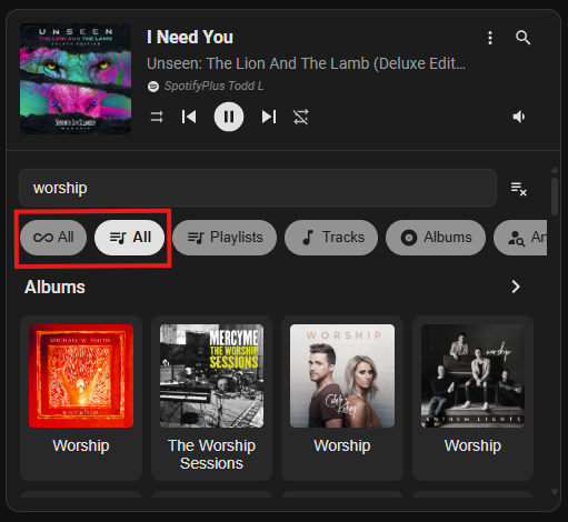

Just released SpotifyPlus Integration v1.0.198 to fix the search issue.
It appears the Mediocre Massive Media Player uses the media_content_type parameter to pass the filter type, and the integration was looking for the media_filter_classes parameter for the filter. I added processing of the media_content_type parameter value, and is working as expected.
Note that the default “All” criteria specified by the card only searches for “tracks”, and not ALL of the custom types specified. I defined a second “All” criteria type that will search ALL of the custom types specified. I would suggest that you contact the author of the card to allow a configuration option to remove the default “All” type button as it’s misleading (e.g. it will not search all types as assumed, only tracks).

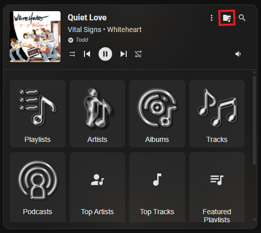

Note that the SpotifyPlus also supports HA Media Browser, so you can use that in your display as well. Just need to configure the media_browser: section of the card configuration, using the SpotifyPlus media player.

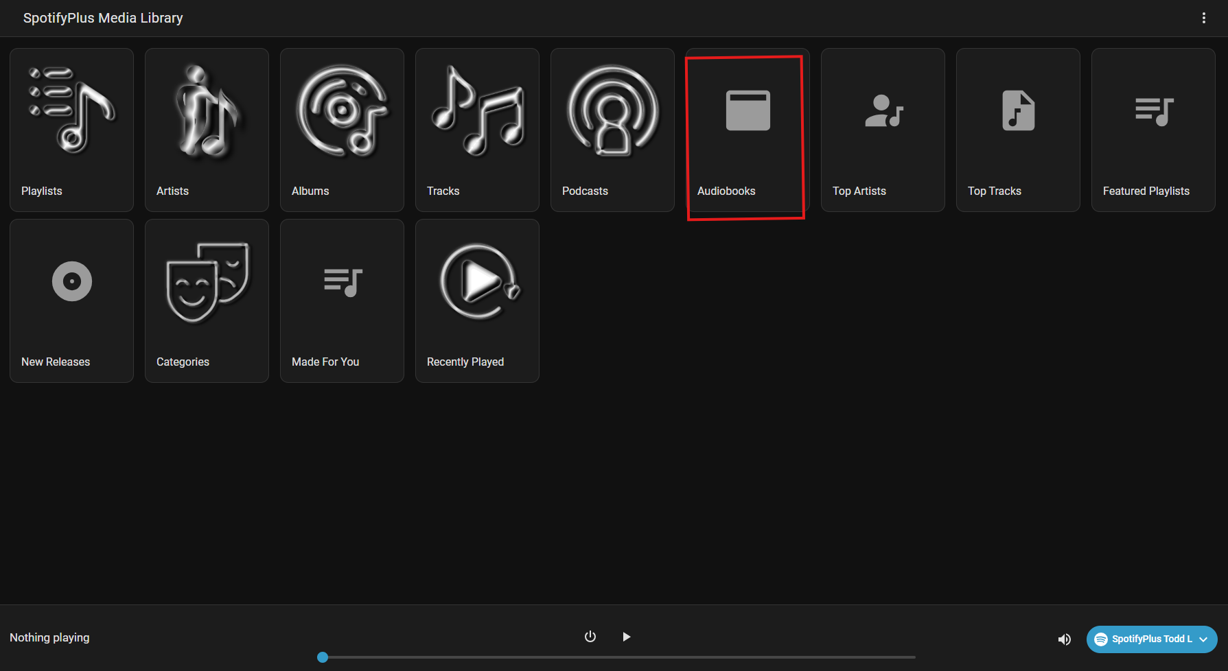

[ 1.0.199 ] - 2026/03/02
  • Added support for Spotify Audiobook favorites to the media browser. The heading in the media browser details will say “App” since HA does not have a media class built for audio books, so I had to utilize the “App” class for Audiobook functionality.
