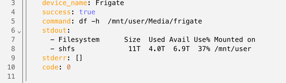

Just found this amazing SSH integration - truly amazing - got it up and running to monitor the temperature of my Coral TPUs in a Frigate Unraid server… so cool…
Getting the above to work was as simple as modifying an example, very easy to copy that but….
Can someone point me to an example or point me in the correct direction to get the following parsed into ideally four sensors.
One for Size, Used, Available, % Used
Any help would be greatly appreciated Thanks and well done on such a great add on
