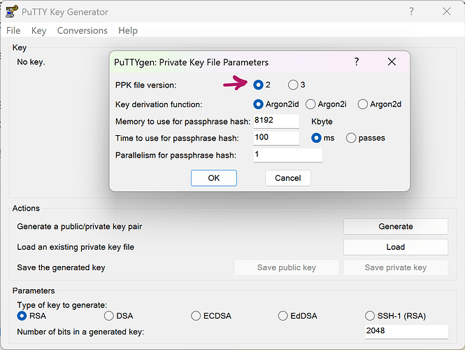

Maybe someone posted it already, but it is solved by reverting to “PPK File version 2”
