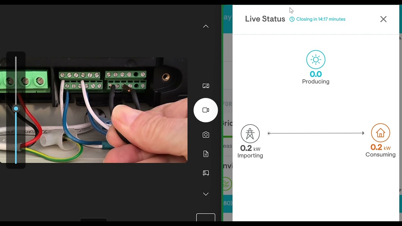

I found this dutch(im dutch :slight_smile: ) page with more info on this DRM/levels:
It has lots info but scroll down you see screenshots of the relays/levels settings.
I also seen this video:
It seems the resistor is still in, and he just connects the 2 with a wire.

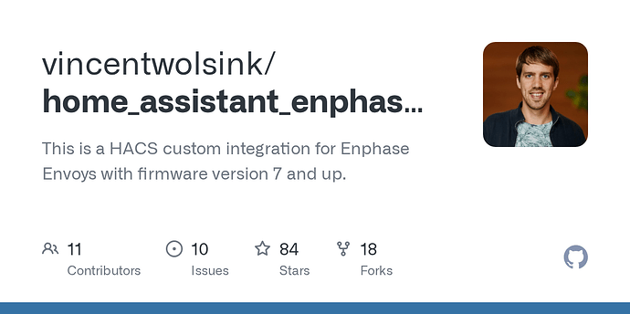

Oh and I forgot to mention in home assistant I use this enphase integration:
This is not the default home assitant integration but one from HACS.
This one gives a “Production” switch that turns on/off all solar production.
And this works on my (non metered) Envoy-S-Standard-EU.
Software Version 8.3.5167
You might need installer access for the production switch, I have installer access since I installed the system myself.

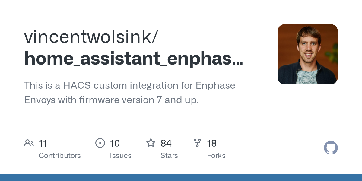

As of about a week ago you don’t need any additional hardware to enable/disable Envoy Dynamic Power Export Limiting - the Pull Request I wrote for the Enphase Envoy (Installer) Home Assistant Integration was accepted and added to release 0.80. The functionality is exposed as simple Home Assistant Services, so you can write simple Automations to enable/disable power export.
Thanks a lot. Do you know how I can prevent problems when I’m currently running the official integration? Is deinstallation of that integration, then installing this one and naming the sensors the same to keep my history enough?
Hi, sorry I’ve been away for a while. Nice bit of research you’ve done, it helps. But I see the update from liamosaur might make the hardware unnecessary!
So, today I tried removing the official integration/removed the Envoy. There was no Envoy integration visible afterwards. Then I installed this version. But I got a notice suggesting there was already something else installed. Any idea on how to get around that message?
