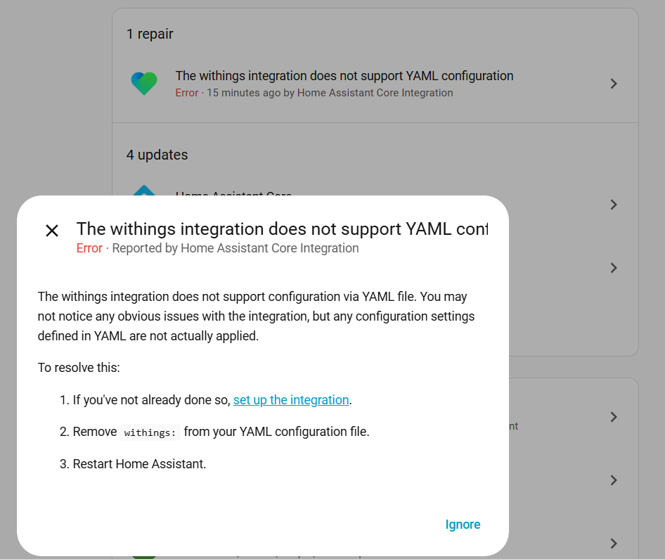

I’m trying to follow these instructions and am having some questions/issues
  • I added the webhook to confiuration.yaml
  • Removed the Withings integration and restarted
  • I re-added the Withings integration and it just automatically connected (no going through the auth again) - is this correct?
  • checked the terminal and got the below - I do not have use_webhook, but i do have a webhook_id… is this an expected state (i’m guessing not… but i get the error below in settings)?
00:00","data":{"auth_implementation":"withings","token":{"access_token":"[hidden]","expires_at":1757085299.058417,"expires_in":10800,"refresh_token":"[hidden]","scope":"user.info,user.metrics,user.activity,user.sleepevents","status":0,"token_type":"Bearer","userid":"44[hidden]"},"webhook_id":"c3184[hidden]"},"disabled_by":null,"discovery_keys":{},"domain":"withings","entry_id":"[hidden]","minor_version":1,"modified_at":"2025-09-05T12:14:59.059154+00:00","options":{},"pref_disable_new_entities":false,"pref_disable_polling":false,"source":"user","subentries":[],"title":"Withings","unique_id":"44601868","version":1}
  • I added the callback url in Withings portal and it turned green
  • I also see the following in Settings:
Can you help?!
