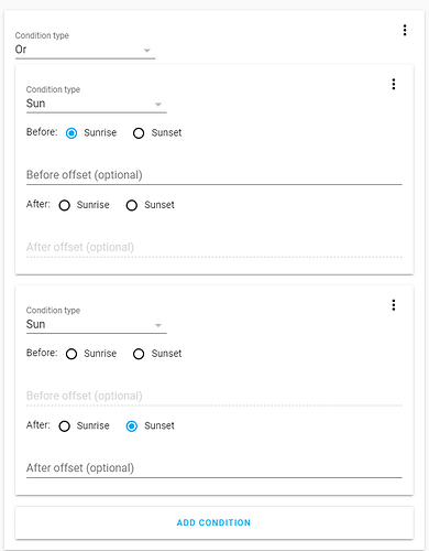

You don’t need two ORs, one OR at the top is enough. Remove the second OR.
You need to create two conditions below the or condition in the editor, you cant have sunrise and sunset in the same condition.

This from your automation is wrong, the example from the docs is fine. You need to create two separate conditions below the or condition. One for the sunset and one for the sunrise.
I believe this is what I have been saying (not sure here or another thread) that the GUI editor is not making the automation correctly. Hopefully the one I now have will work.
It does but you did not use it correctly. When you choose the sun condition in the GUI editor you specify only one, sunrise or sunset. Then you create another condition, choose the sun condition and configure the other part.

Yes exactly like this :slightly_smiling_face: if you compare it to the docs it’s the same only the order is a bit different.

Take a look at the GIF below, I tried to show it, hope the quality is good enough. If you do it exactly like I did in the video, does it not create the YAML I show at the end of the video?

About the dropdown this might be sometjing with supported devices but I don’t know exactly. But if you create the automation like I did and the YAML created for the sun condition is not correct, then there is a bug with your system.
I now understand what I was doing was wrong in the way the GUI was written. I took the “or” as a logic “or” where you need to set the two conditions. Since the two open up when you choose OR in the drop down I was setting it up there. I did not realize that the two it was showing was only the first condition of the or and you need to pick 1 and then need you need to add a second condition. I still think the way it was implemented is wrong, but now I understand how to use it.
I agree that you should not be able to choose before and after, as well as sunrise and sunset in the same condition. You should only be able to choose before or after and then sunrise or sunset.
