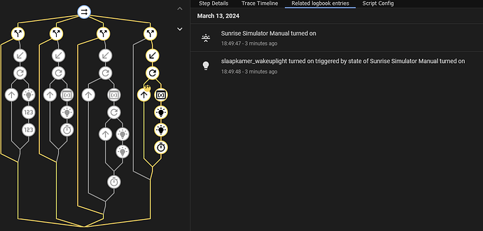

my ledstrip starts in a kind of orange, 2 seconds later in a dark red and doesn’t change anymore :frowning:
where Am I wrong
I have just used the script (also copied the code from Liz and not from original post) and it works as intented.
Some ideas to troubleshoot yours:
  • You may have an automation that controls that light and stops the procedure (please examine your trace on the script)
  • The software from the govee stops somehow reacting
  • The light goes unavailable
  • There are some errors tha stop your script
It is very hard to make the script compatible for everyone since there are are tons of hardware out there and I can’t test them all…
Hope you find a solution :slight_smile:
Thanks for thinking about it, but it looks it doesn’t work for me.
When I start it, I don’t get the orange anymore, only the dark red
this errors are in the log
None (<class ‘custom_components.govee.light.GoveeLightEntity’>) does not set supported color modes
Entity None (<class ‘custom_components.govee.light.GoveeLightEntity’>) is using deprecated supported features values which will be removed in HA Core 2025.1. Instead it should use <LightEntityFeature: 19> and color modes
The govee custom component you have should be updated to set supported color modes as the error says…
Check if there is an available update. That could be the reason why the script stops
Actually it should already work since the error will be relative on 2025.1
Something seems to bother the light and it goes unavailable…
I think the problem is the polling interval
https://www.reddit.com/r/Govee/comments/w9hwii/help_recommended_api_polling_interval/
" You are allowed a total of 60 API calls a minute. So you have to divide that among your number of lights (60 / 6 = 10 calls per light, per minute), but that’s just for current status. You also need some headroom to actually send commands."
Yes that seems to be a problem… If it is true, it’s a govee thing. I’d suggest you to buy a WLED compatible led strip (or replace the govee controller with an esp if it is possible) to solve this problem

The trace for this time shows:
What would be the correct formatting of the parameters in the automation?
I think I figured it out:
I realized that the max_brightness is 100(%) not 255 (max value). When I remove that, the automation works. I also removed the duration for testing but that only gave me 7 minutes instead of 10. So I put it back in and now it works!
