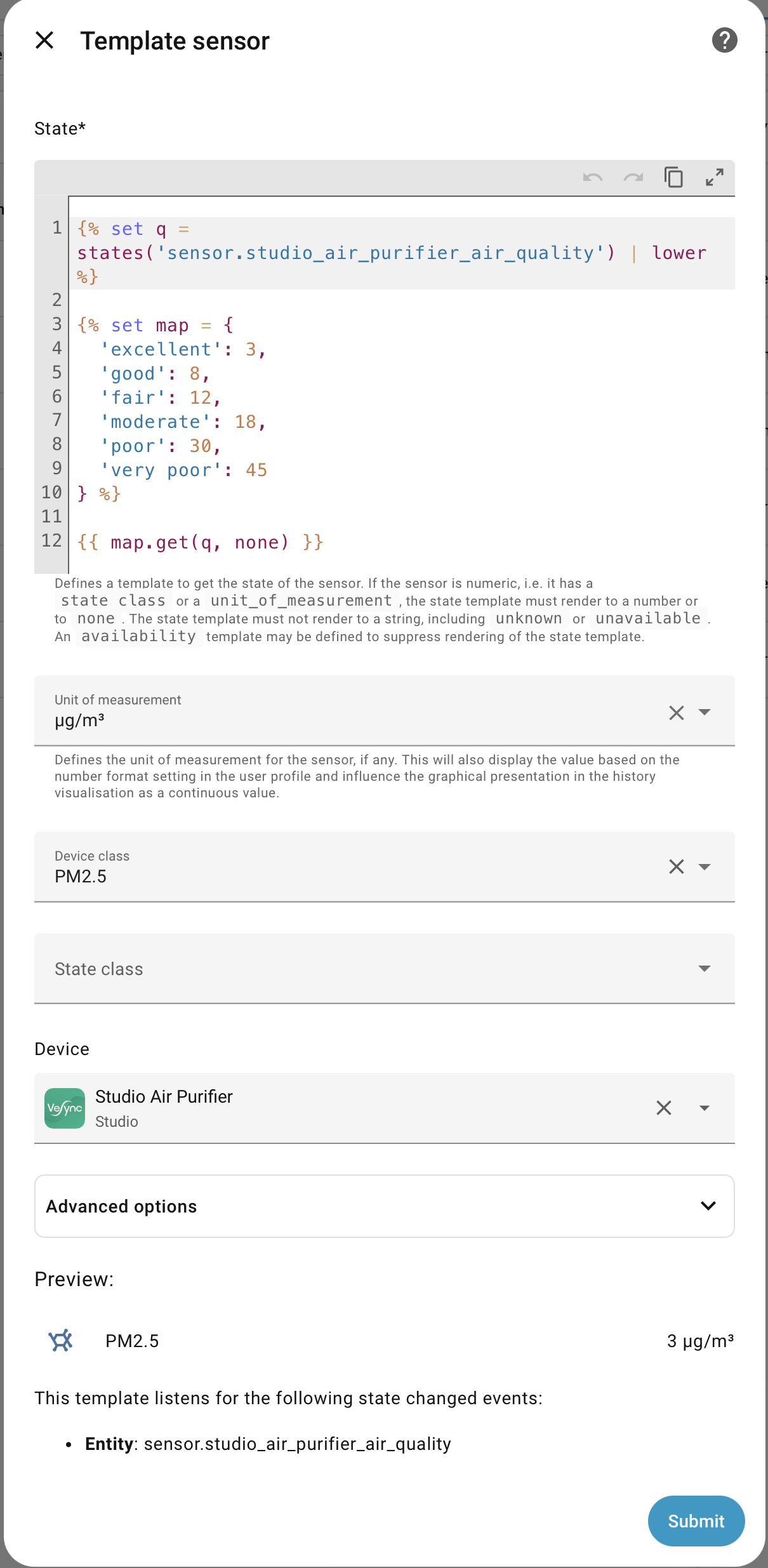

I missed that phrase lol – thank you! however as my air purifiers (winix * 2) don’t have PM2.5 sensor I have to do some manual work I guess – still trying to figure that out
Fans with an attached PM2.5 sensor are automatically exposed as air purifiers, but this can be customized via the configuration
looks like only humidity, pm2.5 and temperature sensors are supported to generate a air purifier with a fan

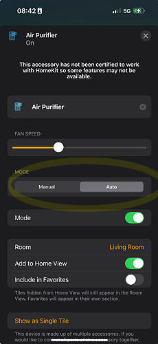

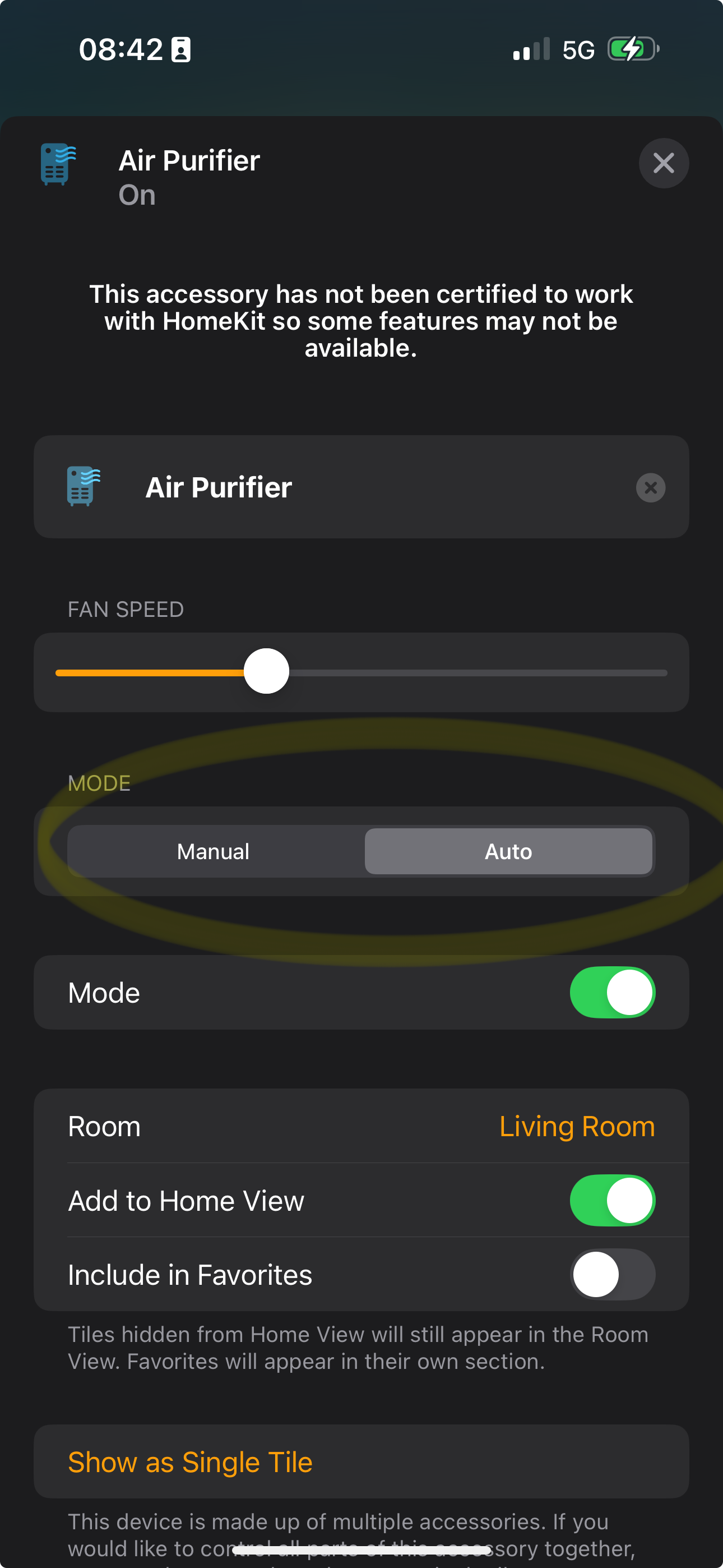

I did the same. Can you switch the air purifier mode in the air purifier card? On mine it only turns on and off and adjusts the speed.
Yes, you can in the settings page of the device. See here:
I’m using a Xiaomi Smart Air Purifier 5 Pro. Switching between Manual and Auto in HomeKit doesn’t work, I don’t know where the problem is and I’m not sure who to report this to. :cry:

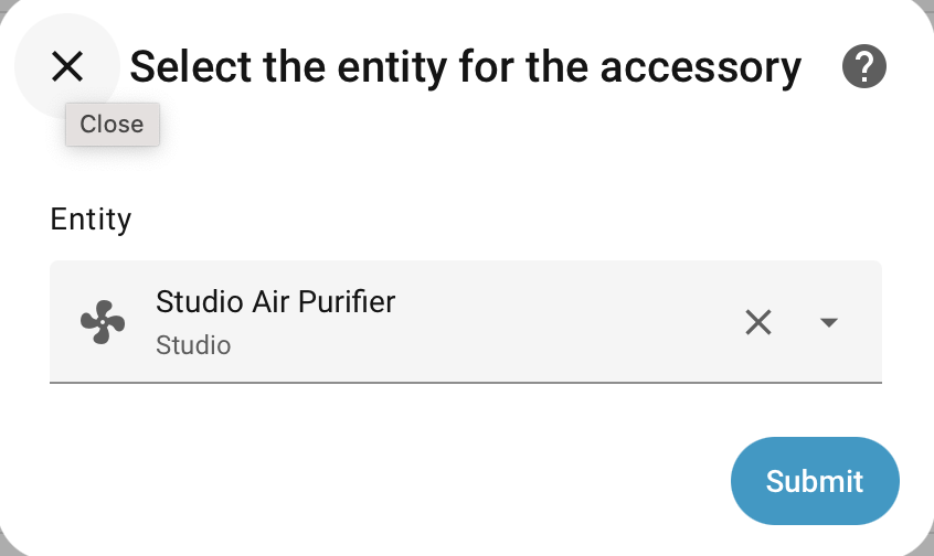

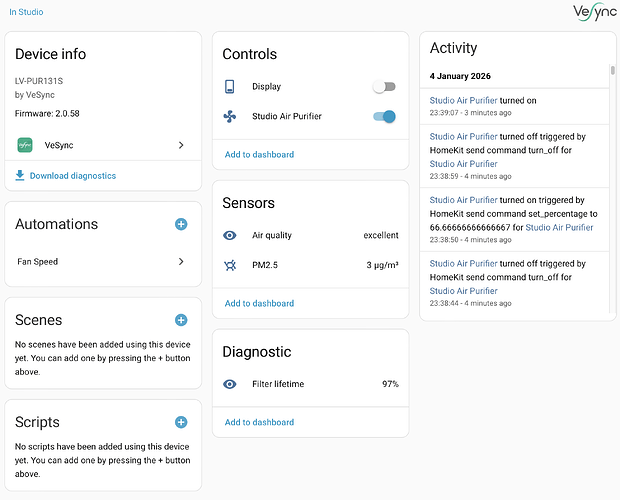

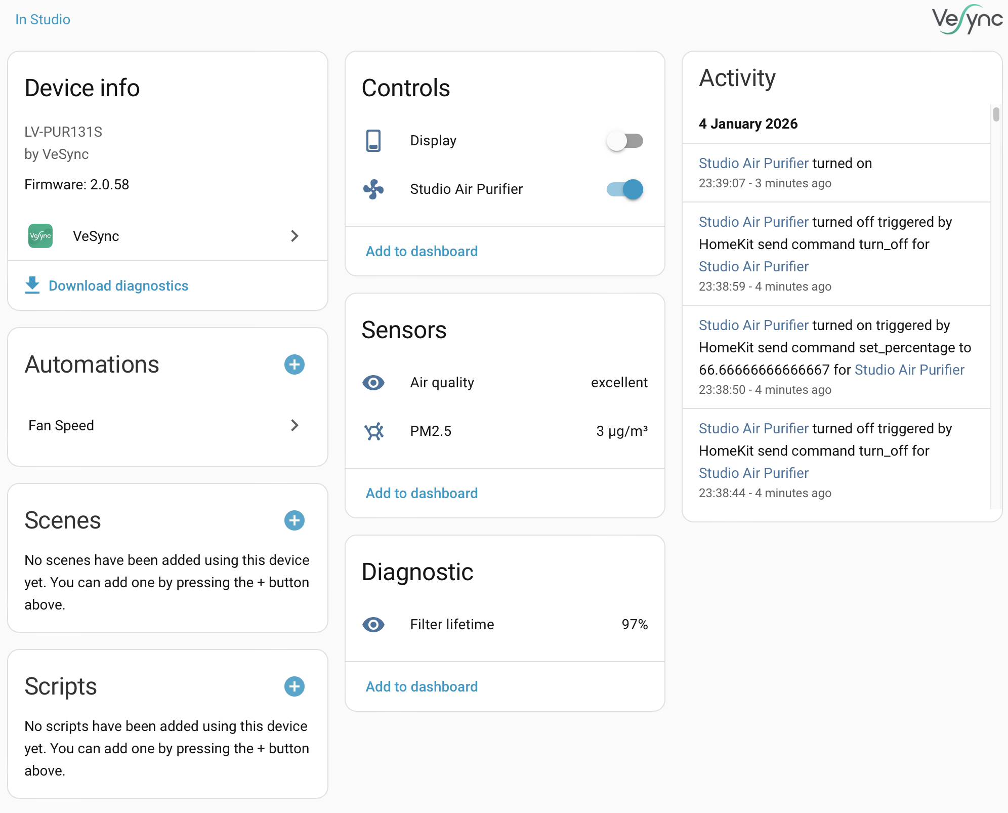

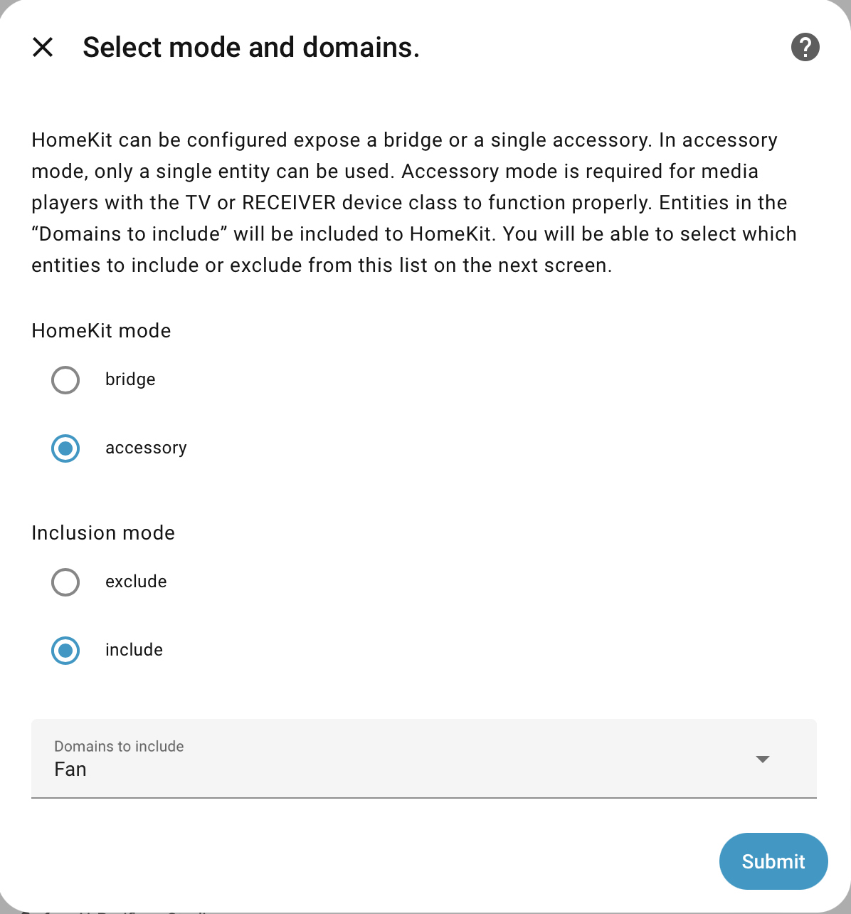

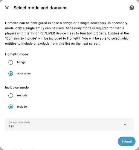

Basically, now it thinks it has a PM2.5 sensor so it shows up in Homekit as an actual Air Purifer (i.e. not just a fan).
Oh yeah, make sure you add it as an accessory…not a bridge…
