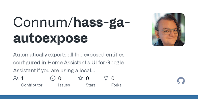

Setting up my local Google Assistant integration, I came across the same issue.
I hacked together a custom component to automatically create the configuration entries for exposed entities based on the configuration via the UI*
* which is only available if the cloud integration is still connected, but an active subscription is not required - I’ll hopefully find the time to activate the UI even without that, but contributions are very welcome, as is any constructive feedback!
I would love to see this integrated into HA by default. Thx for great find

Just FYI, looks like the ability to use the built in “Expose” feature for the manual Google Integration still doesn’t work as of Apri 2026. Good news, if you want something to do this there is a UI solution now that someone took the effort to build.
