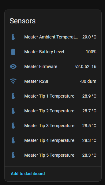

I have a Meater2 Pro (MT-PR20/MT-CP20) and the code earlier in the thread does not work for that. I dug around a bit and here’s code for that if anyone is looking. Still haven’t tested enough to say if the battery % is correct, but temp seems good.
esphome:
  friendly_name: Meater Proxy
esp32:
  board: mhetesp32minikit
  framework:
    type: arduino
globals:
  - id: meater_payload
    type: std::vector<uint8_t>
    restore_value: no
    initial_value: 'std::vector<uint8_t>()'
# Enable logging
logger:
# Enable Home Assistant API
api:
  encryption:
    key: ***
ota:
  - platform: esphome
    password: ***
wifi:
  ssid: !secret wifi_ssid
esp32_ble_tracker:
ble_client:
  - mac_address: XX:XX:XX:XX:XX:XX
text_sensor:
  - platform: template
    name: "Meater Firmware"
    name: "Meater Raw Payload"
    internal: True
sensor:
  - platform: ble_client
    type: characteristic
    ble_client_id: meater
    name: "Meater Raw Payload Trigger"
    internal: true
    service_uuid: 'dcbb67ca-64fb-41a3-99d1-5d9fd8cf33ca'
    characteristic_uuid: '7edda774-045e-4bbf-909b-45d1991a2876'
    notify: true
    lambda: |-
      id(meater_payload) = x;  // Save payload globally
      std::string hex;
      for (auto b : x) {
        char buf[4];
        sprintf(buf, "%02X ", b);
        hex += buf;
      id(meater_raw_payload).publish_state(hex);
      return x.size();  // Dummy return
    name: "Meater Tip 1 Temperature"
    lambda: |-
      auto &x = id(meater_payload);
      if (x.size() < 12) return NAN;
      return (x[0] + (x[1] << 8) + 4.0) / 32.0;
    unit_of_measurement: "°C"
    accuracy_decimals: 1
    device_class: "temperature"
    state_class: "measurement"
    name: "Meater Tip 2 Temperature"
    lambda: |-
      return (x[2] + (x[3] << 8) + 4.0) / 32.0;
    name: "Meater Tip 3 Temperature"
    lambda: |-
      return (x[4] + (x[5] << 8) + 4.0) / 32.0;
    name: "Meater Tip 4 Temperature"
    lambda: |-
      return (x[6] + (x[7] << 8) + 4.0) / 32.0;
    name: "Meater Tip 5 Temperature"
    lambda: |-
      return (x[8] + (x[9] << 8) + 4.0) / 32.0;
    name: "Meater Ambient Temperature"
    lambda: |-
      return (x[10] + (x[11] << 8) + 4.0) / 32.0;
  - name: "Meater Battery Level"
    characteristic_uuid: '2adb4877-68d8-4884-bd3c-d83853bf27b8'
    unit_of_measurement: '%'
    device_class: "battery"
    notify: true
    lambda: |-
      uint8_t battery = x[0];
      return battery;
  - name: "Meater RSSI"
    type: rssi
    device_class: "signal_strength"
  - id: firmware
    service_uuid: '180A'
    characteristic_uuid: '00002a26-0000-1000-8000-00805f9b34fb'
    lambda: |-
      std::string data_string(x.begin(), x.end());
      id(meater_firmware).publish_state(data_string.c_str());
      return x.size();
