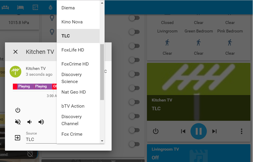

Thank for the feedback and for appreciating my work. :slight_smile: Just from curiosity, does this plugin allow you to change TV channels from a list (dropdown) like mine?
