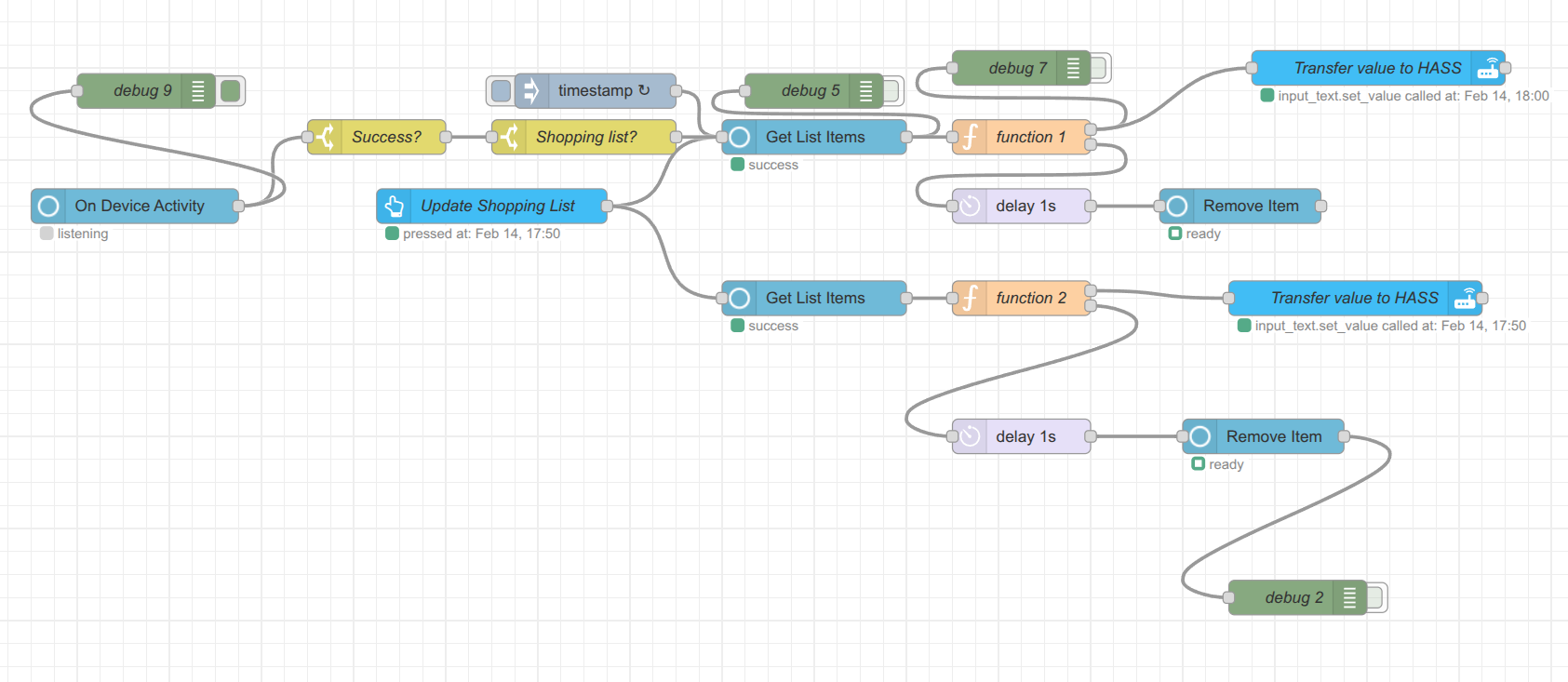

I updated the process in Node-RED to delete the items directly in Alexa after the synchronization finishes successfully.
in this way
its working fine
the principal part is the function definition:

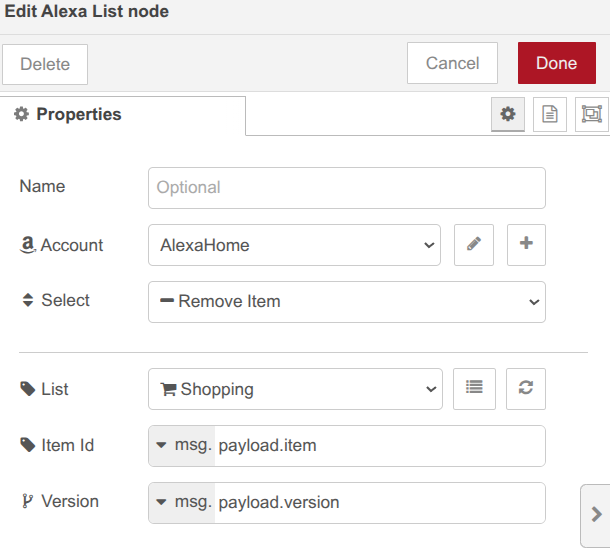

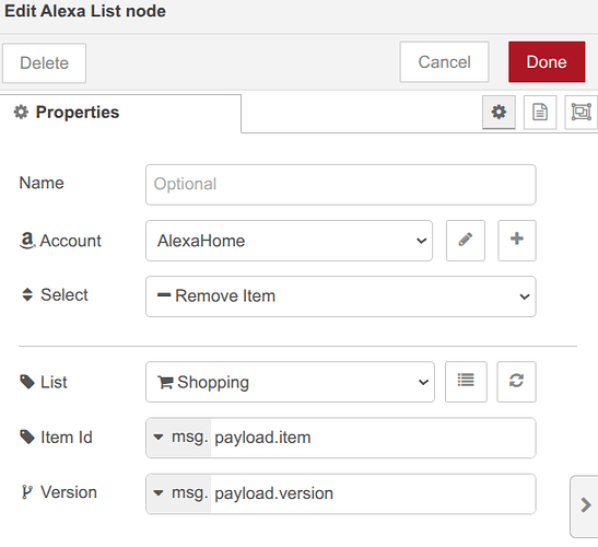

and in Remove Item node like this:
Can you please share the nodered JSON code?
am trying to replicate but am running into a lot of issues. Truly appreciate it.
I wanted to do this too but quickly found out the API is no longer available for list and didn’t like the selenium way
Hi all,
Here is the JSON code
[{“id”:“3141360816c8e7b4”,“type”:“tab”,“label”:“Flow 1”,“disabled”:false,“info”:“”,“env”:},{“id”:“e43b77dd4550b44a”,“type”:“ha-button”,“z”:“3141360816c8e7b4”,“name”:“Update Shopping List”,“version”:0,“debugenabled”:false,“outputs”:1,“entityConfig”:“xxxxxxxxxxxxxxxxx”,“outputProperties”:[{“property”:“payload”,“propertyType”:“msg”,“value”:“string”,“valueType”:“entityState”},{“property”:“topic”,“propertyType”:“msg”,“value”:“”,“valueType”:“triggerId”},{“property”:“data”,“propertyType”:“msg”,“value”:“”,“valueType”:“entity”}],“x”:520,“y”:200,“wires”:[[“9090b4260abf7e93”,“1220666b30e15dab”]]},{“id”:“f209edffca5b827a”,“type”:“alexa-remote-event”,“z”:“3141360816c8e7b4”,“name”:“”,“account”:“put here your data”,“event”:“ws-device-activity”,“x”:210,“y”:200,“wires”:[[“1880922c1bc91fa5”,“a538251f7c35f6fc”]]},{“id”:“67c372ab5edd5da2”,“type”:“inject”,“z”:“3141360816c8e7b4”,“name”:“”,“props”:[{“p”:“payload”},{“p”:“topic”,“vt”:“str”}],“repeat”:“”,“crontab”:“0 7-21 * * *”,“once”:false,“onceDelay”:“10”,“topic”:“”,“payload”:“”,“payloadType”:“date”,“x”:610,“y”:100,“wires”:[[“9090b4260abf7e93”]]},{“id”:“1880922c1bc91fa5”,“type”:“switch”,“z”:“3141360816c8e7b4”,“name”:“Success?”,“property”:“payload.data.utteranceType”,“propertyType”:“msg”,“rules”:[{“t”:“eq”,“v”:“GENERAL”,“vt”:“str”}],“checkall”:“true”,“repair”:false,“outputs”:1,“x”:420,“y”:140,“wires”:[[“3fb7de8493caf86e”]]},{“id”:“3fb7de8493caf86e”,“type”:“switch”,“z”:“3141360816c8e7b4”,“name”:“Shopping list?”,“property”:“payload.description.summary”,“propertyType”:“msg”,“rules”:[{“t”:“cont”,“v”:“shopping list”,“vt”:“str”}],“checkall”:“true”,“repair”:false,“outputs”:1,“x”:600,“y”:140,“wires”:[[“9090b4260abf7e93”]]},{“id”:“9090b4260abf7e93”,“type”:“alexa-remote-list”,“z”:“3141360816c8e7b4”,“name”:“”,“account”:“put here your data”,“config”:{“option”:“getListItems”,“value”:{“list”:{“type”:“str”,“value”:“put here your data”}}},“x”:800,“y”:140,“wires”:[[“dd354411878a7aad”,“bbaba99cd9e5caf2”]]},{“id”:“dd354411878a7aad”,“type”:“debug”,“z”:“3141360816c8e7b4”,“name”:“debug 5”,“active”:false,“tosidebar”:true,“console”:false,“tostatus”:false,“complete”:“payload”,“targetType”:“msg”,“statusVal”:“”,“statusType”:“auto”,“x”:800,“y”:100,“wires”:},{“id”:“bbaba99cd9e5caf2”,“type”:“function”,“z”:“3141360816c8e7b4”,“name”:“function 1”,“func”:“let items = msg.payload;\n\n// 1. Create the string for Home Assistant\nlet displayValues = items.map(item => item.value);\nlet hstMsg = { payload: displayValues.join(‘,’) };\n\n// 2. Prepare ALL items for deletion (No filter)\nlet itemsToDelete = items.map(i => {\n return {\n payload: {\n item: String(i.id),\n version: parseInt(i.version)\n }\n };\n});\n\nreturn [hstMsg, itemsToDelete];”,“outputs”:2,“timeout”:0,“noerr”:0,“initialize”:“”,“finalize”:“”,“libs”:,“x”:980,“y”:140,“wires”:[[“0de6aa72dc8b9498”,“f28f388d41228b77”],[“1db7fbe78770d13a”]]},{“id”:“0de6aa72dc8b9498”,“type”:“debug”,“z”:“3141360816c8e7b4”,“name”:“debug 7”,“active”:false,“tosidebar”:true,“console”:false,“tostatus”:false,“complete”:“true”,“targetType”:“full”,“statusVal”:“”,“statusType”:“auto”,“x”:980,“y”:80,“wires”:},{“id”:“f28f388d41228b77”,“type”:“api-call-service”,“z”:“3141360816c8e7b4”,“name”:“Transfer value to HASS”,“server”:“put here your data”,“version”:7,“debugenabled”:false,“action”:“input_text.set_value”,“floorId”:,“areaId”:,“deviceId”:,“entityId”:[“input_text.shoppingliststring”],“labelId”:,“data”:“{"value":"{{payload}}"}”,“dataType”:“json”,“mergeContext”:“”,“mustacheAltTags”:false,“outputProperties”:,“queue”:“none”,“blockInputOverrides”:false,“domain”:“input_text”,“service”:“set_value”,“x”:1290,“y”:80,“wires”:[]},{“id”:“a538251f7c35f6fc”,“type”:“debug”,“z”:“3141360816c8e7b4”,“name”:“debug 9”,“active”:true,“tosidebar”:true,“console”:false,“tostatus”:false,“complete”:“true”,“targetType”:“full”,“statusVal”:“”,“statusType”:“auto”,“x”:220,“y”:100,“wires”:},{“id”:“1220666b30e15dab”,“type”:“alexa-remote-list”,“z”:“3141360816c8e7b4”,“name”:“”,“account”:“put here your data”,“config”:{“option”:“getListItems”,“value”:{“list”:{“type”:“str”,“value”:“put here your data”}}},“x”:800,“y”:280,“wires”:[[“444d0218fd3d5332”]]},{“id”:“444d0218fd3d5332”,“type”:“function”,“z”:“3141360816c8e7b4”,“name”:“function 2”,“func”:“let items = msg.payload;\n\n// 1. Create the string for Home Assistant\nlet displayValues = items.map(item => item.value);\nlet hstMsg = { payload: displayValues.join(‘,’) };\n\n// 2. Prepare ALL items for deletion (No filter)\nlet itemsToDelete = items.map(i => {\n return {\n payload: {\n item: String(i.id),\n version: parseInt(i.version)\n }\n };\n});\n\nreturn [hstMsg, itemsToDelete];”,“outputs”:2,“timeout”:0,“noerr”:0,“initialize”:“”,“finalize”:“”,“libs”:,“x”:980,“y”:280,“wires”:[[“cf1da4149b38235a”],[“e181a591ab85639b”]]},{“id”:“cf1da4149b38235a”,“type”:“api-call-service”,“z”:“3141360816c8e7b4”,“name”:“Transfer value to HASS”,“server”:“put here your data”,“version”:7,“debugenabled”:false,“action”:“input_text.set_value”,“floorId”:,“areaId”:,“deviceId”:,“entityId”:[“input_text.shoppingliststringfarmacia”],“labelId”:,“data”:“{"value":"{{payload}}"}”,“dataType”:“json”,“mergeContext”:“”,“mustacheAltTags”:false,“outputProperties”:,“queue”:“none”,“blockInputOverrides”:false,“domain”:“input_text”,“service”:“set_value”,“x”:1270,“y”:280,“wires”:[]},{“id”:“de3c5fa27fb7a997”,“type”:“alexa-remote-list”,“z”:“3141360816c8e7b4”,“name”:“”,“account”:“put here your data”,“config”:{“option”:“removeItem”,“value”:{“list”:{“type”:“str”,“value”:“put here your data”},“item”:{“type”:“msg”,“value”:“payload.item”},“version”:{“type”:“msg”,“value”:“payload.version”}}},“x”:1190,“y”:400,“wires”:[[“86c031919ee649b3”]]},{“id”:“86c031919ee649b3”,“type”:“debug”,“z”:“3141360816c8e7b4”,“name”:“debug 2”,“active”:false,“tosidebar”:true,“console”:false,“tostatus”:false,“complete”:“true”,“targetType”:“full”,“statusVal”:“”,“statusType”:“auto”,“x”:1220,“y”:540,“wires”:},{“id”:“e181a591ab85639b”,“type”:“delay”,“z”:“3141360816c8e7b4”,“name”:“”,“pauseType”:“delay”,“timeout”:“1”,“timeoutUnits”:“seconds”,“rate”:“1”,“nbRateUnits”:“1”,“rateUnits”:“second”,“randomFirst”:“1”,“randomLast”:“5”,“randomUnits”:“seconds”,“drop”:false,“allowrate”:false,“outputs”:1,“x”:980,“y”:400,“wires”:[[“de3c5fa27fb7a997”]]},{“id”:“1db7fbe78770d13a”,“type”:“delay”,“z”:“3141360816c8e7b4”,“name”:“”,“pauseType”:“delay”,“timeout”:“1”,“timeoutUnits”:“seconds”,“rate”:“1”,“nbRateUnits”:“1”,“rateUnits”:“second”,“randomFirst”:“1”,“randomLast”:“5”,“randomUnits”:“seconds”,“drop”:false,“allowrate”:false,“outputs”:1,“x”:980,“y”:200,“wires”:[[“32463a6c032c0ba6”]]},{“id”:“32463a6c032c0ba6”,“type”:“alexa-remote-list”,“z”:“3141360816c8e7b4”,“name”:“”,“account”:“put here your data”,“config”:{“option”:“removeItem”,“value”:{“list”:{“type”:“str”,“value”:“put here your data”},“item”:{“type”:“msg”,“value”:“payload.item”},“version”:{“type”:“msg”,“value”:“payload.version”}}},“x”:1170,“y”:200,“wires”:[]},{“id”:“xxxxxxxxxxxxxxxxx”,“type”:“ha-entity-config”,“server”:“xxxxxxxxxxxxxxxxx”,“deviceConfig”:“xxxxxxxxxxxxxxxxx”,“name”:“Update Shopping List”,“version”:6,“entityType”:“button”,“haConfig”:[{“property”:“name”,“value”:“Updat Shopping List”},{“property”:“icon”,“value”:“”},{“property”:“entity_picture”,“value”:“”},{“property”:“entity_category”,“value”:“config”},{“property”:“device_class”,“value”:“update”}],“resend”:false,“debugEnabled”:false},{“id”:“xxxxxxxxxxxxxxxxx”,“type”:“server”,“name”:“Home Assistant”,“addon”:true},{“id”:“xxxxxxxxxxxxxxxxx”,“type”:“ha-device-config”,“name”:“Node Red Buttons”,“hwVersion”:“”,“manufacturer”:“Node-RED”,“model”:“”,“swVersion”:“”},{“id”:“7bdc5fa7eae53679”,“type”:“global-config”,“env”:,“modules”:{“node-red-contrib-home-assistant-websocket”:“0.80.3”,“node-red-contrib-alexa-remote2-applestrudel”:“5.0.55”}}]
