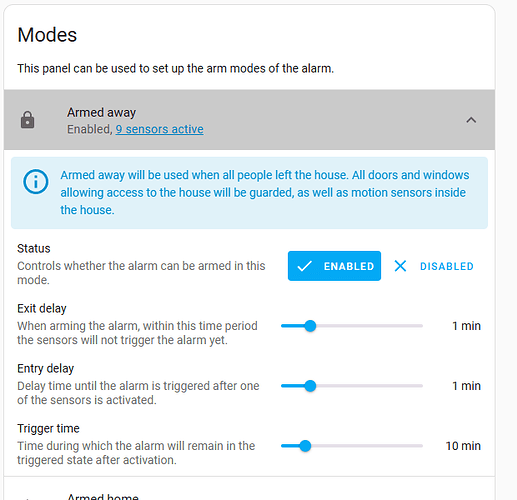

Set the exit delay in Alarmo. Not on the keypad.
I do have delay set but the keypad doesn’t seem to sound the beeps. It only says away and armed after the exit delay timeout… is the keypad faulty? I purchased it from ebay but was brand new in packaging

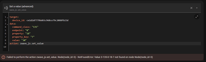

Error while executing automation automation.ring_keypad_v2: Node(node_id=2) - NotFoundError: Value 2-135-0-18-7 not found on node Node(node_id=2)

I’m facing issue too for entry/exit delay, seems not valid:
Yep, some investigation is needed from an expert, do you have any idea @ImSorryButWho ?
Thanks very much to @jsnallen on Github for finding the issue: ZWaveJS changed the way they handle the Indicator CC in version 15.10, which broke the entry/exit delay. You should be able to re-install this blueprint to get the correct behavior back.
