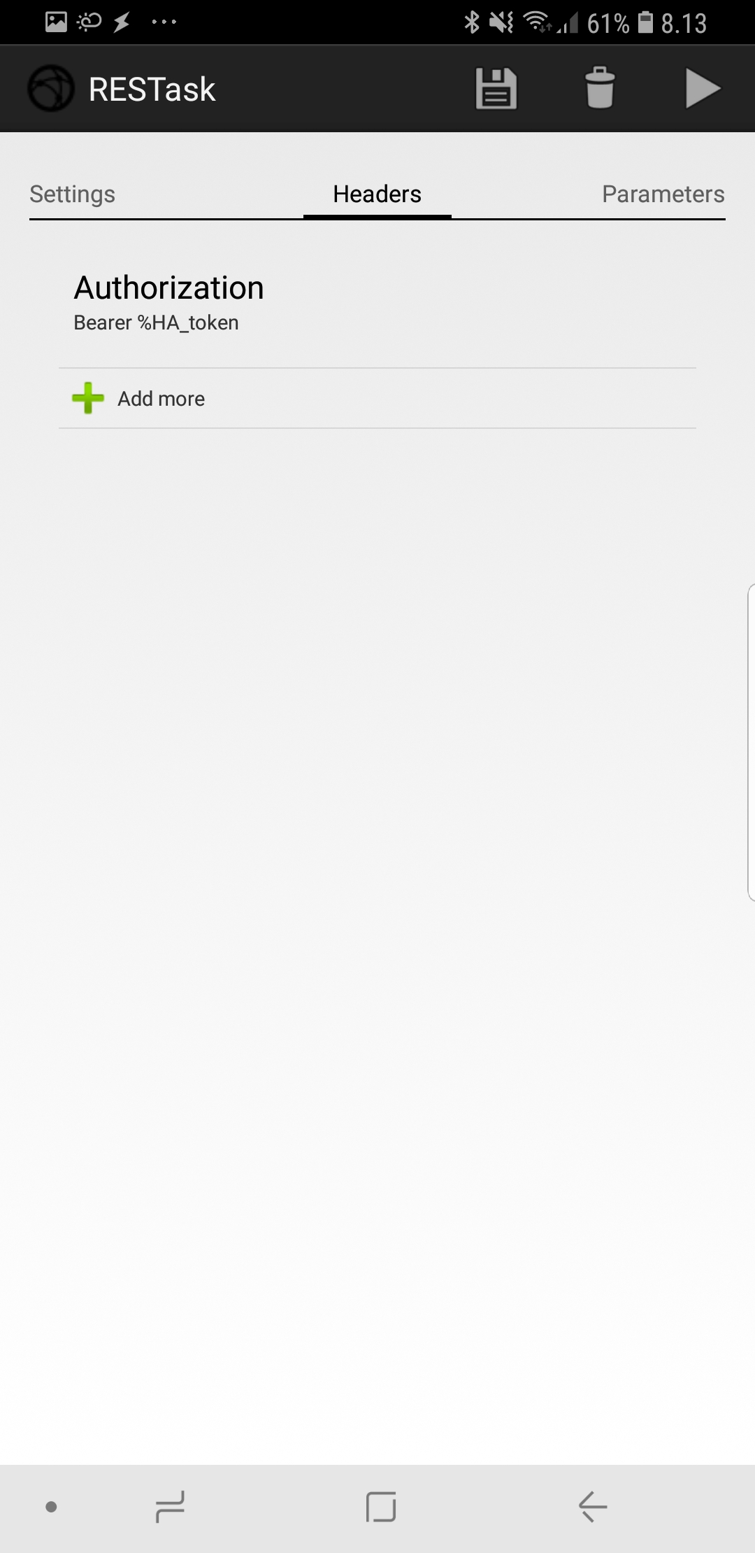

@poratnir This can be also done with webhooks and without tasker plugin “RESTask”. Pictures are from RESTask. For testing and running from RESTask own play button, replace the “%HA_token” with your actual token.
