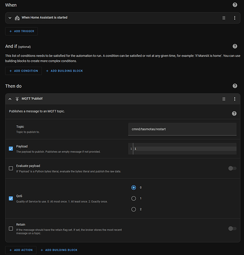

Anyway on the information tab I found out they subscribe to a couple of group topics including the tasmotas one:
This is very convenient for the automation as you only need to publish one command to reboot them all and forget about its maintenance:
