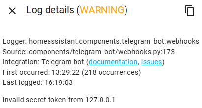

I just checked my logs and saw this error which I didn’t see come up before:
Where would I add or check the secret token?
OK I found out the issue! It looks like the new UI Integration of Telegram does not like the hidden password from my .secrets file…refer to the above log error message. When I pasted the actual API key in to the Webhook .yaml file and restarted it now works.

For the Invalid secret token from 127.0.0.1
error, the issue isn’t related to secrets.
You probably had 2 Telegram webhook bots and the secrets were overwriting each other.
It’s a bug in the integration.
