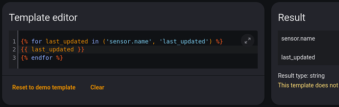

{% for last_updated in ('sensor.name', 'last_updated') %}
  1. You created a loop that will run twice… once for the string ‘sensor.name’ and again for the string ‘last_updated’. While the loop is running, the variable last_updated will hold those strings as it’s value, each in it’s own turn. This can be seen in the following results from the Template Editor tool:

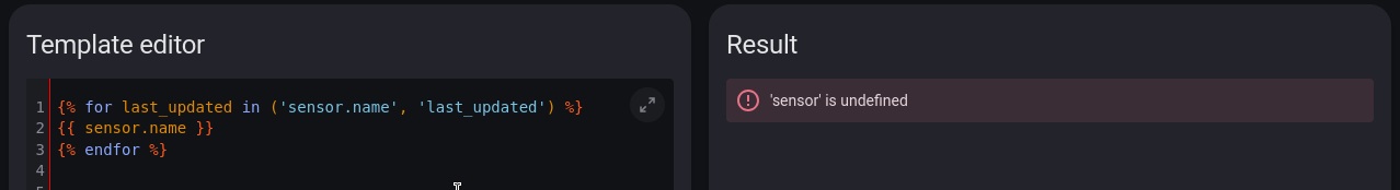

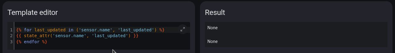

{{ sensor.name }}: {{ state_attr('sensor.name', 'last_updated') }}
3a. Inside this loop there is no defined variable sensor so sensor.name is meaningless.
3b. Unless you actually have an entity in your Home Assistant instance with the entity ID “sensor.name”, the second part will always render none. Also last_updated and last_changed are properties of the state object, not state attributes, so they are not accessible with the function state_attr().
