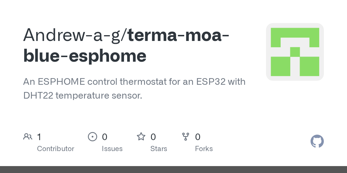

Coming back to this after 4 years I’ve managed to port this to ESPHome with the help of claude. The main issue was the persistent connection. The homekit example also helped massively. Hope this helps someone and brings this radiator into 2026 smart homes.
