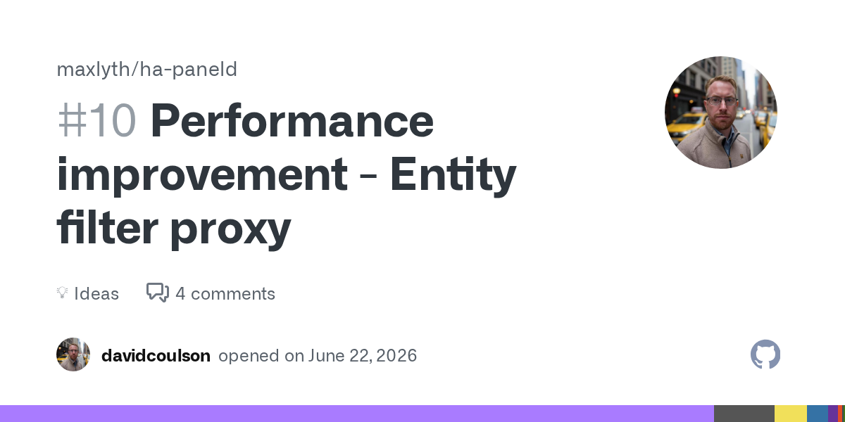

FYI ha-paneld is getting support for entity filtering - I just installed the 0.9.2-rc2 version on my wall tablet and migrated from HA-WebSocket-Stripper over to their filtering. Seems to work just as well.
