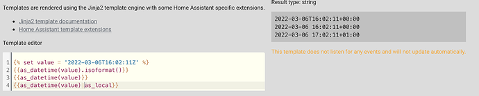

an mqtt sensor has value
2022-03-06T16:02:11Z and my local time is 1 earlier than that.
I want it to show a timestamp (and have the frontend show the relative time) so use:
{{as_datetime(value).isoformat()}} # or
{{as_datetime(value)}}
resulting in
which is still an put off.
trying as_local Adds an hour…
now how do I get it to subtract that 1 hour…?
I did see the Zulu time being mentioned as early in this thread as The EPIC Time Conversion and Manipulation Thread! - #11 by finity but it doesnt really help me find the answer.

Now that I’m at a computer, dt.tzinfo shows you your time zone info. So after you convert a time string using as_datetime, you can see the results.
Pasting this code will show you the differences:
x
{%- macro doit(dt) %}{{ (dt | string).ljust(25) }} | {{ dt.tzinfo }}{%- endmacro %}
{% set value = '2022-03-06T16:02:11Z' %}
{{ doit(value | as_datetime) }}
{{ doit(value.replace('Z','') | as_datetime) }}
{{ doit(value.replace('Z','') | as_datetime | as_local) }}
2022-03-06 16:02:11+00:00 | UTC
2022-03-06 16:02:11       | None
2022-03-06 16:02:11+01:00 | whatever TZ this is
Your time zone is +1 currently (possibly with DST?)
