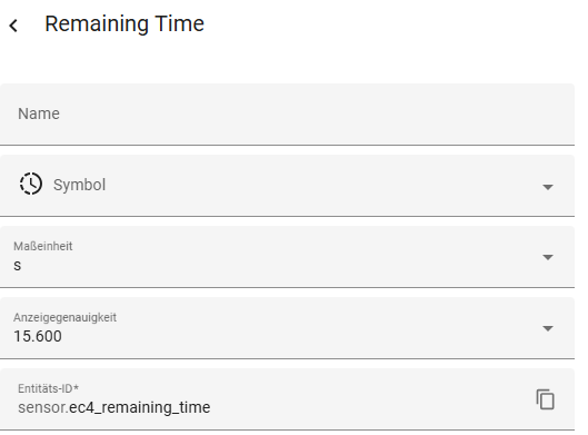

One more question though…
Here what is visible in developer tools:
I am wondering how to make the UI, e.g. entity card or entities card showing the duration as as d HH:MM:SS. Where d is days, HH is hours, MM is minutes and SS is seconds.
Entities card:
the entity itself:
of course I could create a template helper containing the right formatting but wouldn’t expect that it is needed to have a helper only for displaying an existing entity.
Post your full configuration for the sensor.
