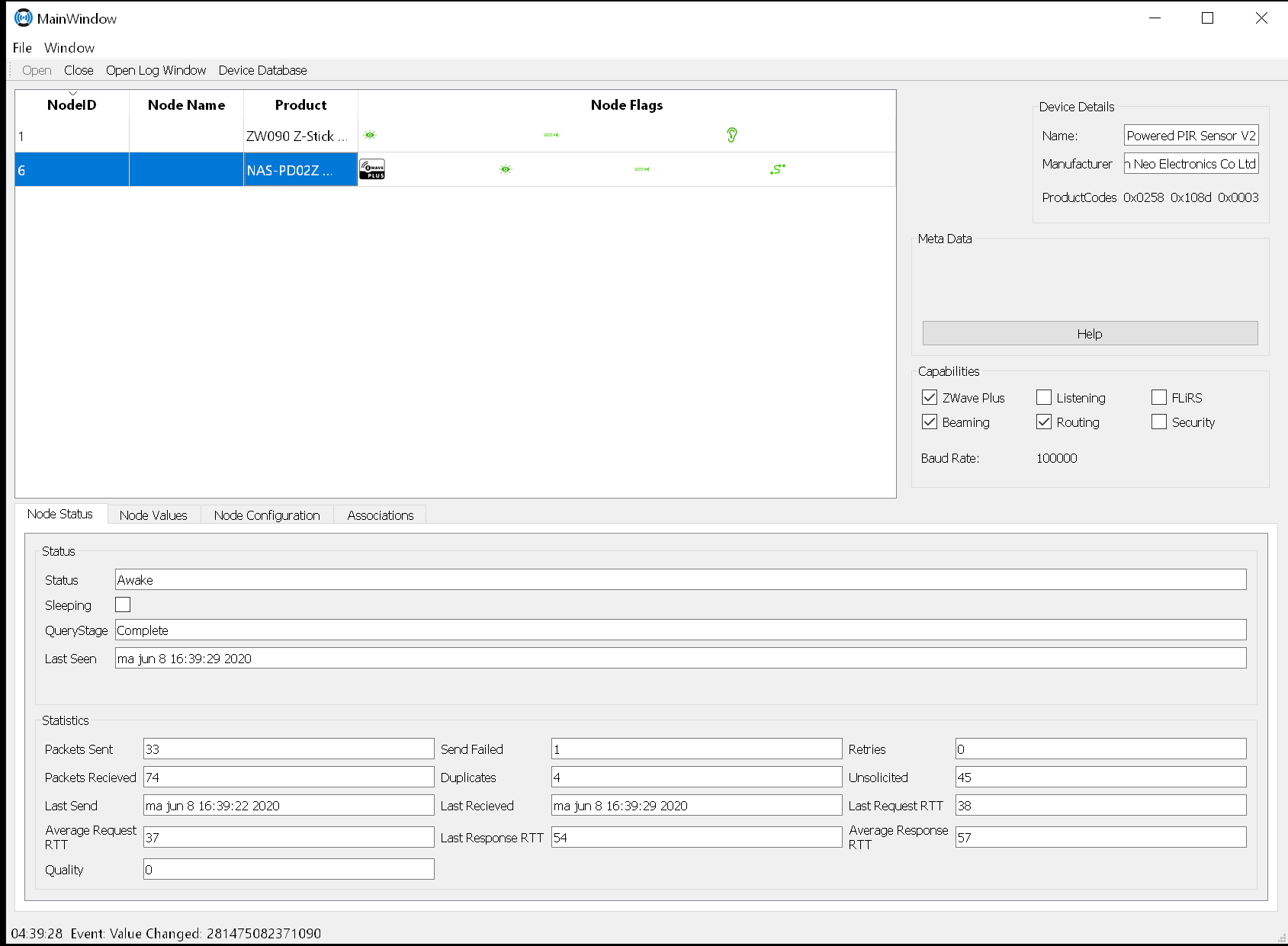

Hi, I have it again… Zwave device unavailable reboot of the addon does not help.
And then manual wake on the sensor:
what’s that?
